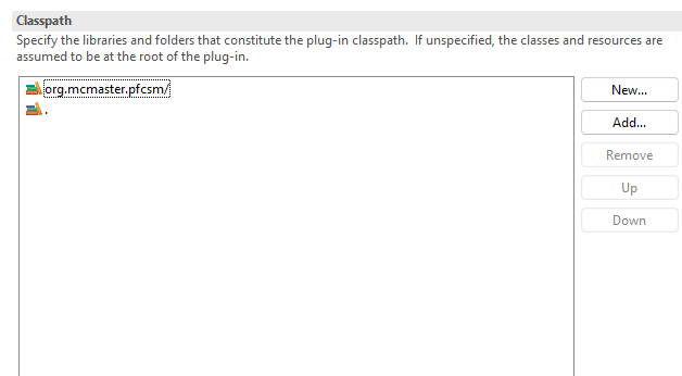

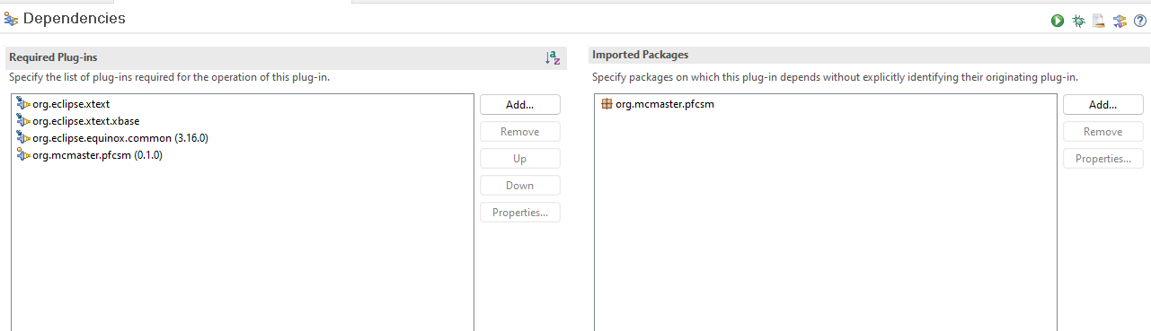

Re: Accessing Enum from imported ECore model [message #1860243 is a reply to message #1860242] Mon, 24 July 2023 14:56 Go to previous messageGo to next message
I just added the reference but I'm still getting the same error.
I've removed the ecore model from the classpath, but left it in the dependencies as you said:
index.php/fa/43347/0/
Still getting the
Couldn't resolve reference to EPackage 'http://www.example.org/pfcsm'.
error. Is the MWE2 file the correct file to be editing or is there another one that I should be looking for?
[Updated on: Mon, 24 July 2023 15:15] by Moderator

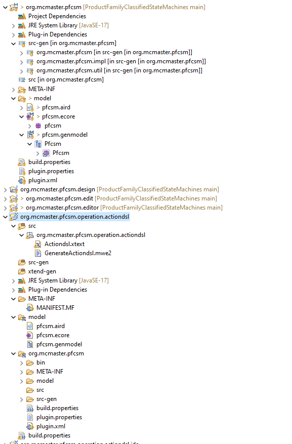

Re: Accessing Enum from imported ECore model [message #1860244 is a reply to message #1860243] Mon, 24 July 2023 14:59 Go to previous messageGo to next message
can you please share your project layouts, where the ecore and genmodels are etc, the workflow file etc.
there are 100000 possible combinations i cannot guess
e.g.
add
referencedResource="platform:/resource/org.mcmaster.pfcsm/model/whatever.genmodel"
to the language section of the workflow
[Updated on: Mon, 24 July 2023 15:01] by Moderator
Re: Accessing Enum from imported ECore model [message #1860245 is a reply to message #1860244] Mon, 24 July 2023 15:08 Go to previous messageGo to next message
Here is an image of the project explorer
index.php/fa/43348/0/
I've also zipped up the projects together if it helps.
Re: Accessing Enum from imported ECore model [message #1860246 is a reply to message #1860245] Mon, 24 July 2023 15:12 Go to previous messageGo to next message
adjusting workflow to
language = StandardLanguage {
referencedResource="platform:/resource/org.mcmaster.pfcsm/model/pfcsm.genmodel"
works perfectly fine for me
Re: Accessing Enum from imported ECore model [message #1860247 is a reply to message #1860246] Mon, 24 July 2023 15:17 Go to previous message
Ok I didn't understand that it wasn't in the import section of the MWE2 file that needed to be changed. I've added that to the same spot and it works now too for me.
