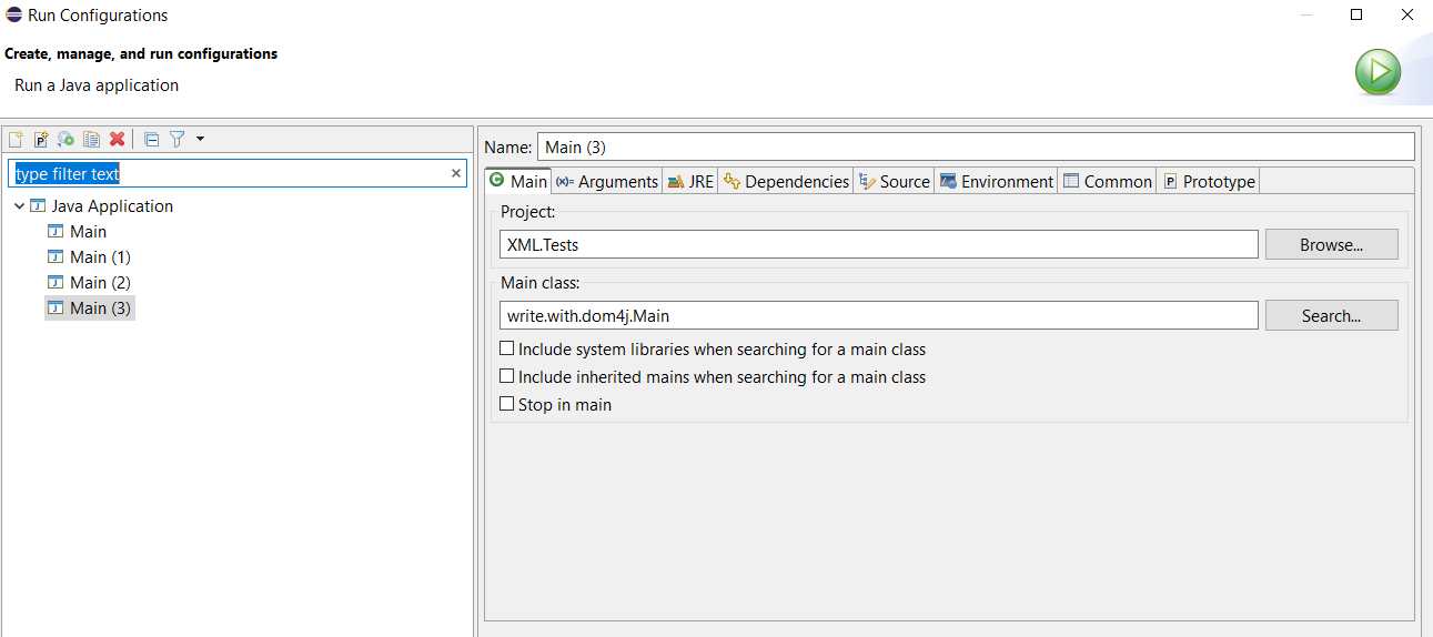

When I run the Main class of a given package, eclipse create run configurations that looks like this:
index.php/fa/42861/0/

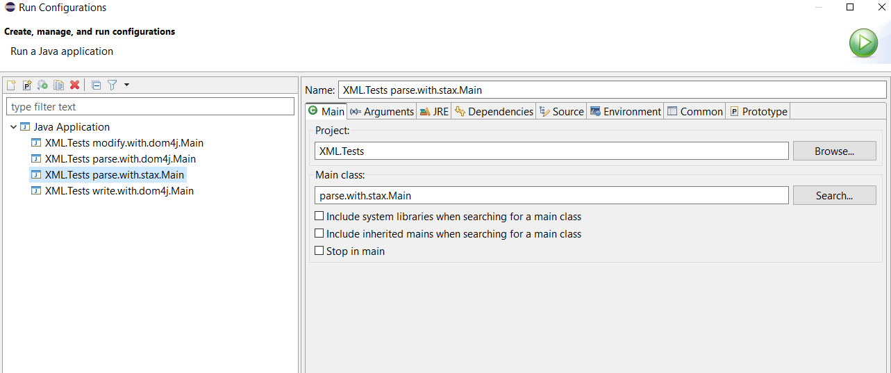

IMHO, it will be more useful and time saver to create run configuration with a name in a format like <project> <full class name> so
the run configurations will look like this:
index.php/fa/42862/0/

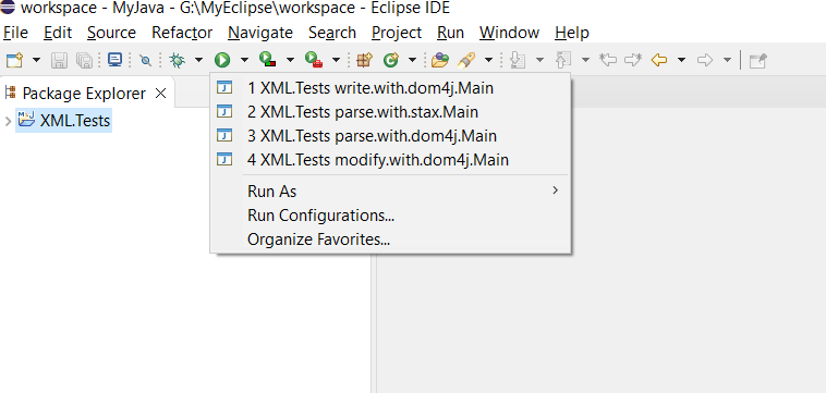

The biggest time saver that we will have is in the "run popup" that will look like this:
index.php/fa/42863/0/

When I wrote <full class name> I meant qualified name as the picture above show.
