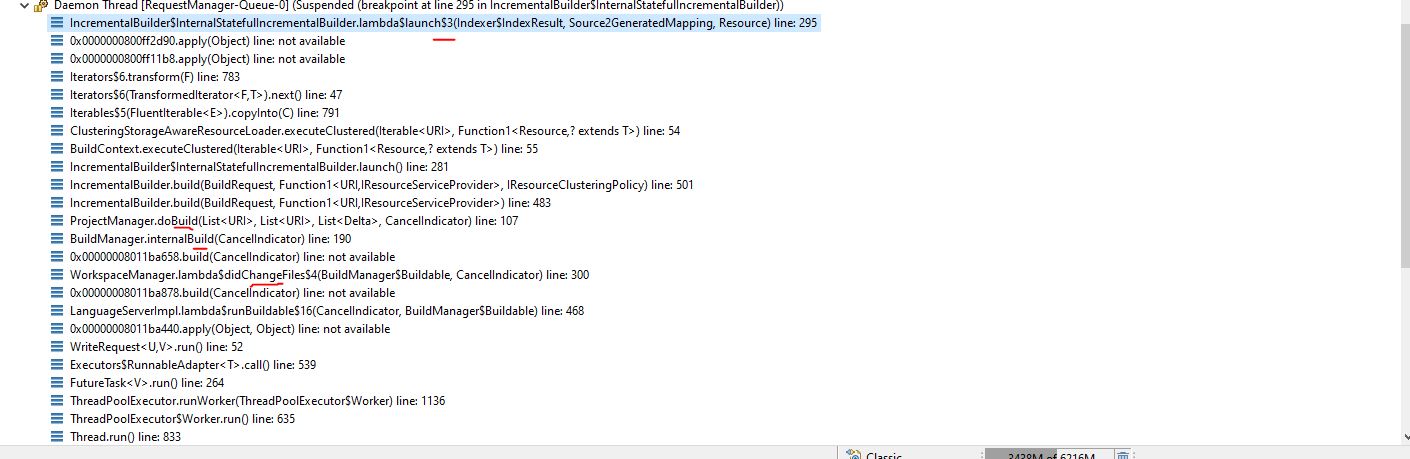

@Christian Dietrich Thank you for quick reply.
To answer your question
In IncrementalBuilder we have a method validate(Resource resource)
call stack : LanguageServerImpl[didChange->toBuildable]
WorkspaceManager[didChangeTextDocumentContent->didChangeFiles] ->BuildManager [submit-->internalBuild] IncrementalBuilder[launch]
I have attached debug call stack for reference.
does this information is sufficient?

Re: Code completion is leading to validation execution in language server [message #1856405 is a reply to message #1856402] Thu, 08 December 2022 09:38 Go to previous messageGo to next message
but where is content assist in this picture?

Re: Code completion is leading to validation execution in language server [message #1856407 is a reply to message #1856405] Thu, 08 December 2022 10:04 Go to previous messageGo to next message
Christian Dietrich
As per my understanding this is a direct invocation of method public void didChange(DidChangeTextDocumentParams params) from client what i meant is through rpc. content assist execution is in separate thread.
[Updated on: Thu, 08 December 2022 10:05] by Moderator
Re: Code completion is leading to validation execution in language server [message #1856408 is a reply to message #1856407] Thu, 08 December 2022 10:06 Go to previous messageGo to next message
but if you change the file you change the file? so the client tells the server that the file changed.
so you expect didChange not to trigger validation. but how do you want to trigger validation then?
