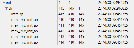

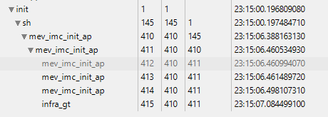

Re: How to set PTID in Trace Compass [message #1854720 is a reply to message #1854693] Sat, 03 September 2022 17:10 Go to previous message
Thanks Matthew, it work! :)
Do you know why it works only when I start recording the session before I run my app?
I uploaded two files that show how it looks in Control Flow view in both cases.
1. capture.png - First start recording lttng session and then my app
2. capture2.png - Run my app and then lttng session.
Thanks, I need IRQ's as well.
I am using Trace Compass version 8.0.0.
Thanks, I will take a look on this lttng-utils.
Also, can you think of a reason why I see usermode (green) on my threads
only when they run on CPU0 but not when they run on CPU1?
Can it be something related to the way I defined the lttng recording session?
Thank you Matthew, it really helps.
  • Attachment: Capture.PNG
    (Size: 8.85KB, Downloaded 100 times)
  • Attachment: Capture2.PNG
    (Size: 8.65KB, Downloaded 101 times)
