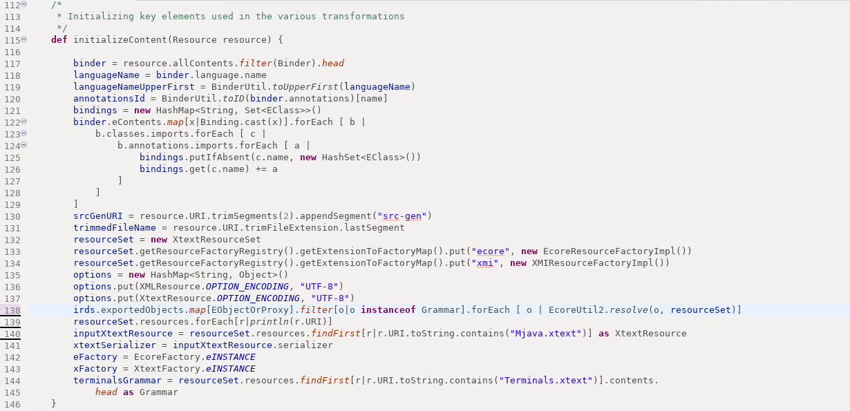

I am looking for help in using the Xtext serializer to save an Xtext grammar that was programmatically created as an EMF resource.

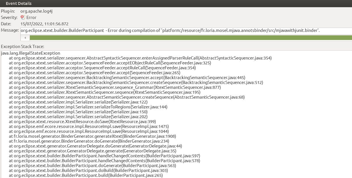

My various attempts always fail when it comes to using the save instruction from the XtextResource (log error in screenshot below).
My project consists in creating an Xtext grammar resulting from the merge of several grammars, after which this new grammar needs to be serialized. While the creation of the new grammar as well as the imports of the rules coming from the other grammars work perfectly, exceptions are triggered when it comes to saving the resource. I have been looking for examples that showcase the use of the resource and serializer in similar cases, but did not manage to find anything relevant.
Please find below other pieces of information and screenshots featuring how I use the serializer and what error is triggered in the process.
I use eclipse 2022-06 and org.eclipse.justj.openjdk.hotspot.jre.full.linux.x86_64_18.0.1.v20220515-1614 as a JRE.

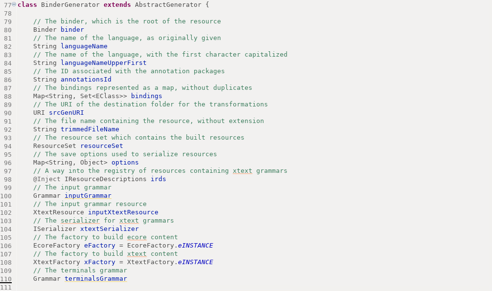

Here is the constructor in wich you can see how the serializer is created starting from line 132:
index.php/fa/42315/0/
index.php/fa/42316/0/

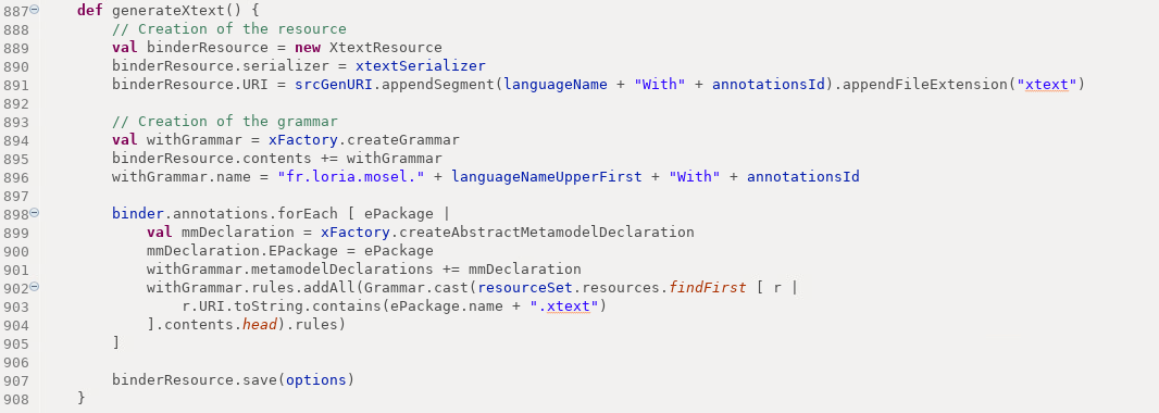

Here is how I generate the new Xtext Grammar using the previous serializer and options:
index.php/fa/42317/0/
Here is the log error printed when trying to run it:
index.php/fa/42318/0/

Re: Unability to serialize an Xtext grammer created with EMF [message #1853854 is a reply to message #1853849] Wed, 20 July 2022 00:28 Go to previous messageGo to next message
The code looks very strange
Normally stuff is created using injectors and not using new
