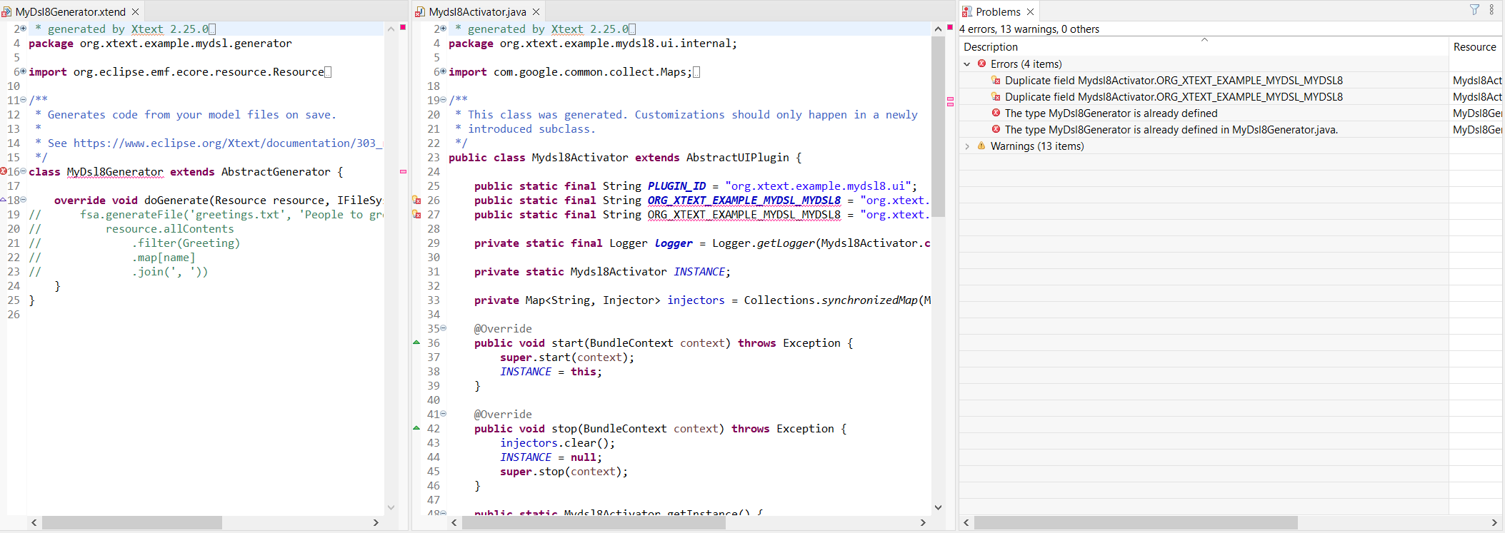

Hi again,
sorry, I also get these errors.
index.php/fa/42024/0/
Thanks.
Kind regards,
Antonio

Re: Multiple Xtext files and Same Ecore [message #1852082 is a reply to message #1852078] Thu, 28 April 2022 09:29 Go to previous messageGo to next message
455 [main] INFO text.xtext.generator.XtextGenerator - Generating org.xtext.example.mydsl.MyDsl8
1172 [main] INFO text.xtext.generator.XtextGenerator - Generating org.xtext.example.mydsl.MyDsl8
i see
// automatically generated by Xtext
grammar org.xtext.example.mydsl.MyDsl8 with org.eclipse.xtext.common.Terminals
and
so name is the same
