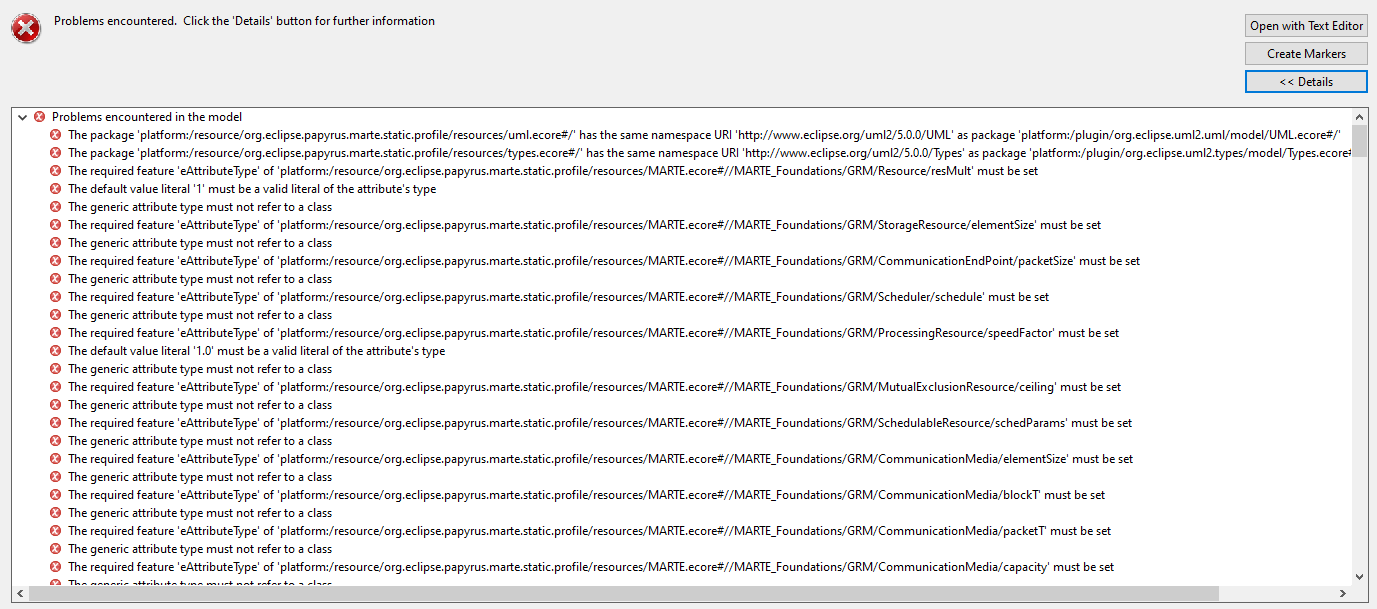

Hello everybody,
I've created an UML profile that depends on MARTE 1.2.2.
Then I've created the file .genmodel to generate the java classes of the profile.
When I open the file .genmodel, it returns the attached errors related to MARTE.
Do you know why it happens?
Moreover, if I try to generate the java classes, some of them needs MARTE files that do not exists, such as:
org.eclipse.papyrus.MARTE_Library.BasicNFP_Types.NFP_Integer;
org.eclipse.papyrus.MARTE_Library.BasicNFP_Types.NFP_Real;
org.eclipse.papyrus.MARTE_Library.BasicNFP_Types.NFP_String;
I'm using Eclipse 03-2021.
Alberto

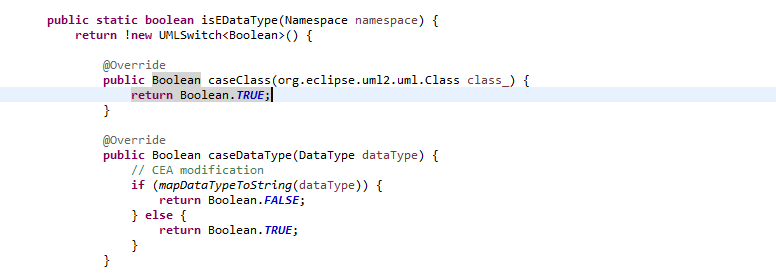

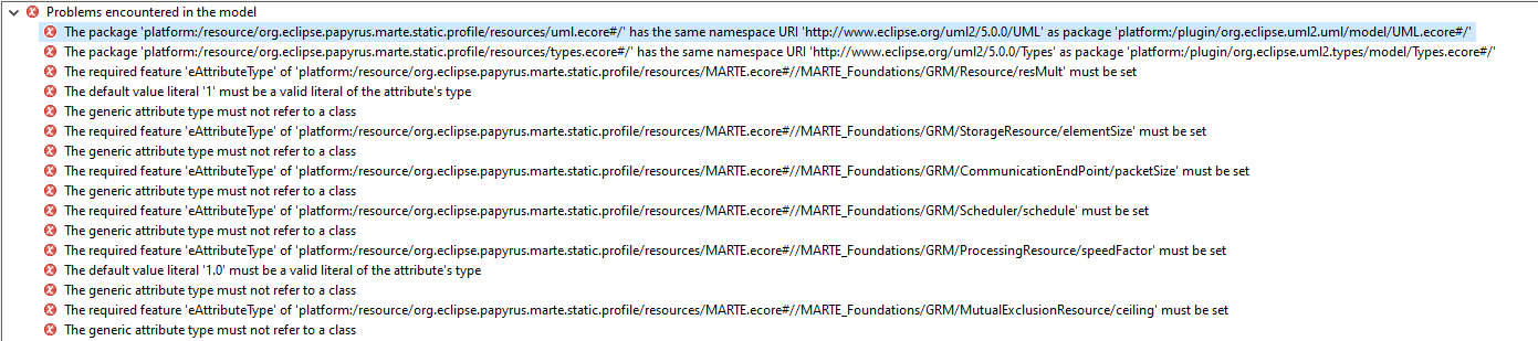

I'm using the patch, but I still have the attached errors.
Did I miss something in the procedure?
Alberto

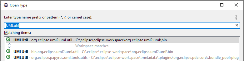

Did you do a reload of the .genmodel file? (in a 2nd Eclipse instance, assuring that the patch is taken into account)
Re: MARTE errors on genmodel [message #1851132 is a reply to message #1851125] Mon, 28 March 2022 09:51 Go to previous messageGo to next message
I reloaded the model.
In the 2nd Eclipse instance, if I search the type "UMLUtil", Eclipse links to the patched class (see the attached screenshots).

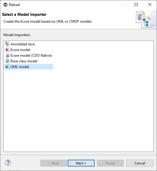

Re: MARTE errors on genmodel [message #1851487 is a reply to message #1851481] Wed, 06 April 2022 09:25 Go to previous messageGo to next message
Did you use the UML model importer during the reload? (available in the UML2 extender SDK) ?
Where I can verify this?
I use UML model (see the attached image).

Re: MARTE errors on genmodel [message #1851490 is a reply to message #1851487] Wed, 06 April 2022 09:46 Go to previous messageGo to next message
Yes, that's the right import variant.
