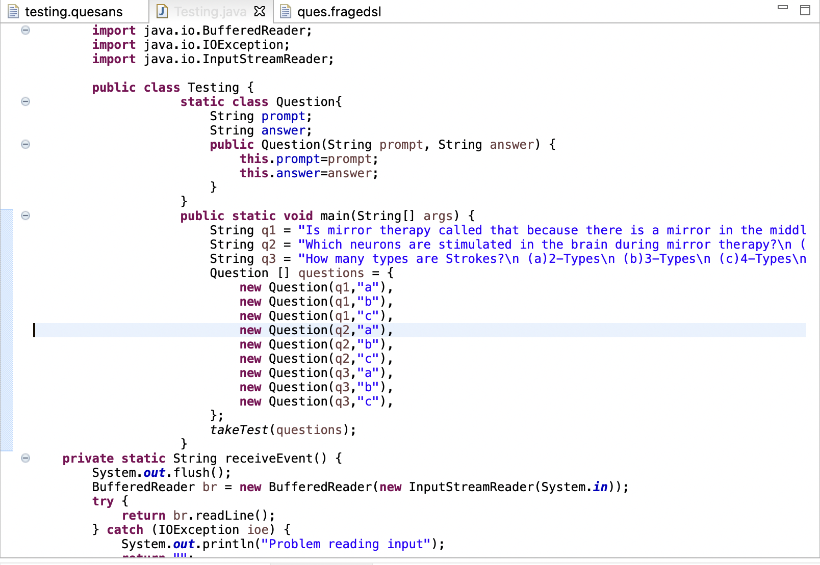

I have written a grammar for a quiz program and after declaring the question I have created a class to which I am passing the question as well as the answer. Now, in the xtend generator file I have a problem. I want to loop through the questions and answer and save them in an array on the same index with a comma. I have difficulty in doing so.
Grammar is written below: Plus in image 1 if you see line 52 I am filtering through the "AskQuestions" in which I have questions as well as answers and in image 2 if you see the main method in that there is a questions array and question 1(q1) is repeating with all three options.
Now, my question is how can I change the loop in the xtend generator file that values will add in the array when indexof of both the questions and answers is the same. I have to avoid repetition.
I want like this:
Questions [ ] questions [
new Question(q1,a),
new Question(q2,c),
new Question(q2,b),

Re: Generate correct code in xtend [message #1850316 is a reply to message #1850314] Thu, 24 February 2022 23:29 Go to previous messageGo to next message
Use FOR ... SEPARATOR „,"
Re: Generate correct code in xtend [message #1850317 is a reply to message #1850316] Thu, 24 February 2022 23:35 Go to previous messageGo to next message
Sorry, I didn't understand. Can you correct this piece of code.
«FOR ques:questions.show»
«FOR ans:questions.ans»
new Question(«ques.name»,"«ans.value»"),
«ENDFOR»
«ENDFOR»

Re: Generate correct code in xtend [message #1850319 is a reply to message #1850318] Fri, 25 February 2022 00:17 Go to previous messageGo to next message
No, You understood it wrong.
Right now, if you see in image 2 q1 in the Question array is repeating 3 times because of the loop. I want that q1,q2,q3 to only occur once as I have defined in the grammar checking file (Which is attached below)
answers[
question(q1,"a"),
question(q2,"b"),
question(q3,"c")
Re: Generate correct code in xtend [message #1850320 is a reply to message #1850318] Fri, 25 February 2022 00:18 Go to previous messageGo to next message
is there a reson to do such a bad grammar design?
if yes you can try the indexed method:
«FOR ques:questions.show.indexed»
new Question(«ques.value.name»,"«questions.ans.get(ques.key).value»"),
«ENDFOR»
Re: Generate correct code in xtend [message #1850321 is a reply to message #1850320] Fri, 25 February 2022 00:23 Go to previous messageGo to next message
No, not any special reason.
I am a beginner. You have understood the scenario. Can you rewrite the grammar in a good way. Thank you in advance.
Re: Generate correct code in xtend [message #1850322 is a reply to message #1850321] Fri, 25 February 2022 00:35 Go to previous messageGo to next message
something like (pseudo grammar)
AskQuestions:
"answers[" (andas+=QuestionWithAnwer)+ "]" ;
QuestionWithAnwer:
"question("show+=[Statements] "," ans+=Answer ")" (",")*;
Re: Generate correct code in xtend [message #1850381 is a reply to message #1850322] Mon, 28 February 2022 09:23 Go to previous message
Thanks a lot. This grammar is really a professional one.
