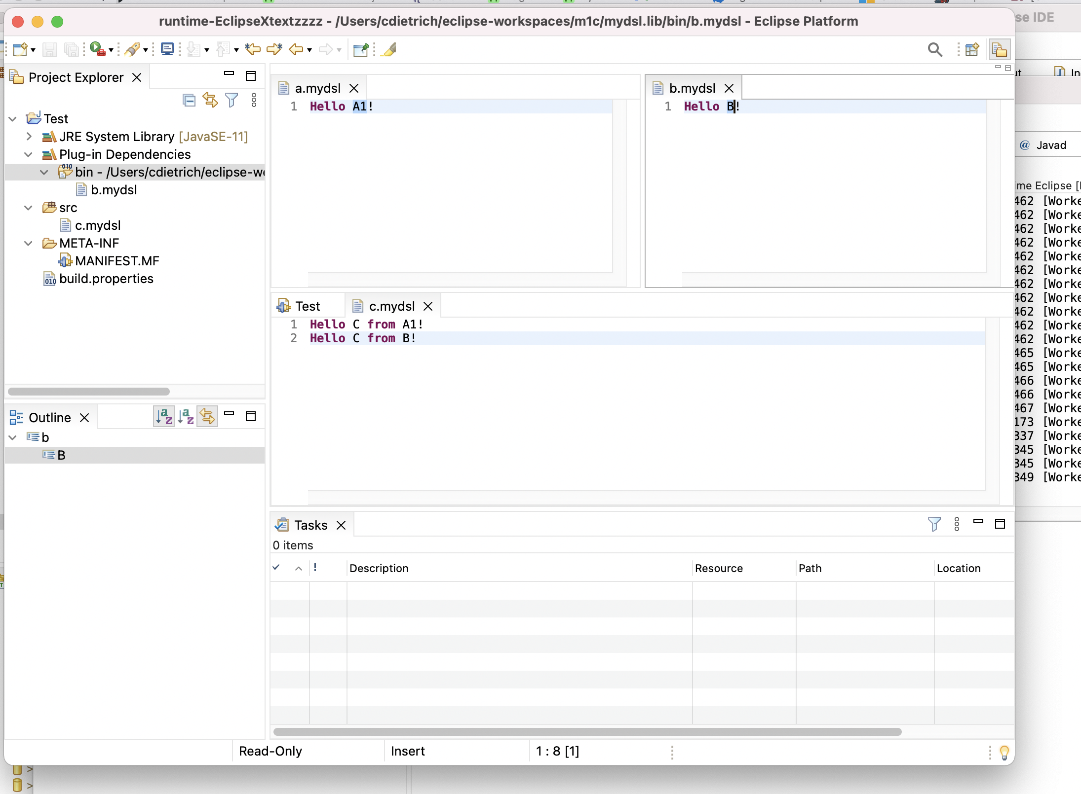

index.php/fa/41675/0/
with my simple experiments i cannot reproduce your problem
