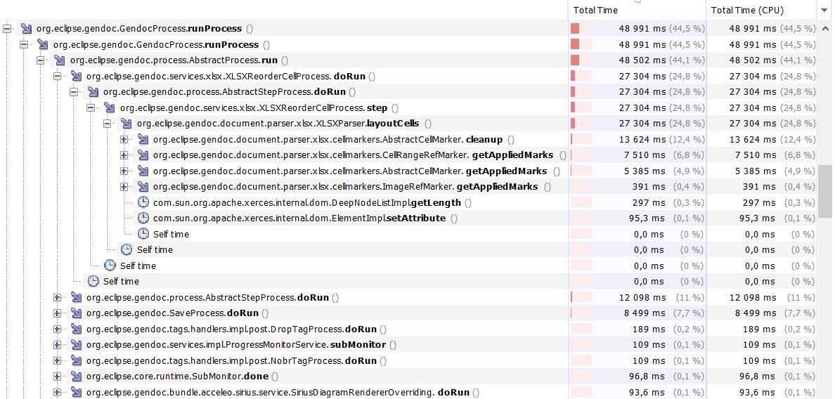

We generate a big enough xlsx file. The method XLSXParser::layoutCells() works very slow:
index.php/fa/41365/0/
The image shows just a snapshot. The process is not even finished.
It seems that the performance issue is caused by rows.getLength() in the following method:

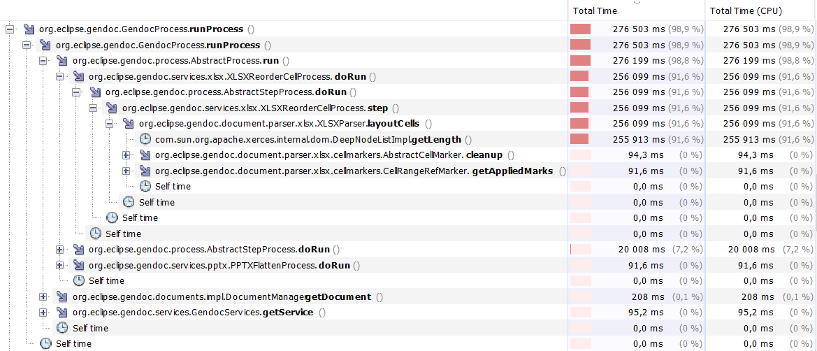

Re: XLSXParser::layoutCells() performance issue [message #1848248 is a reply to message #1848224] Thu, 25 November 2021 22:44 Go to previous messageGo to next message
I added a cache for getLength(). It works significantly faster now. At least the generation process is finished. But now the next method with a performance issue is item():
index.php/fa/41375/0/
I'll try to implement the iteration differently.

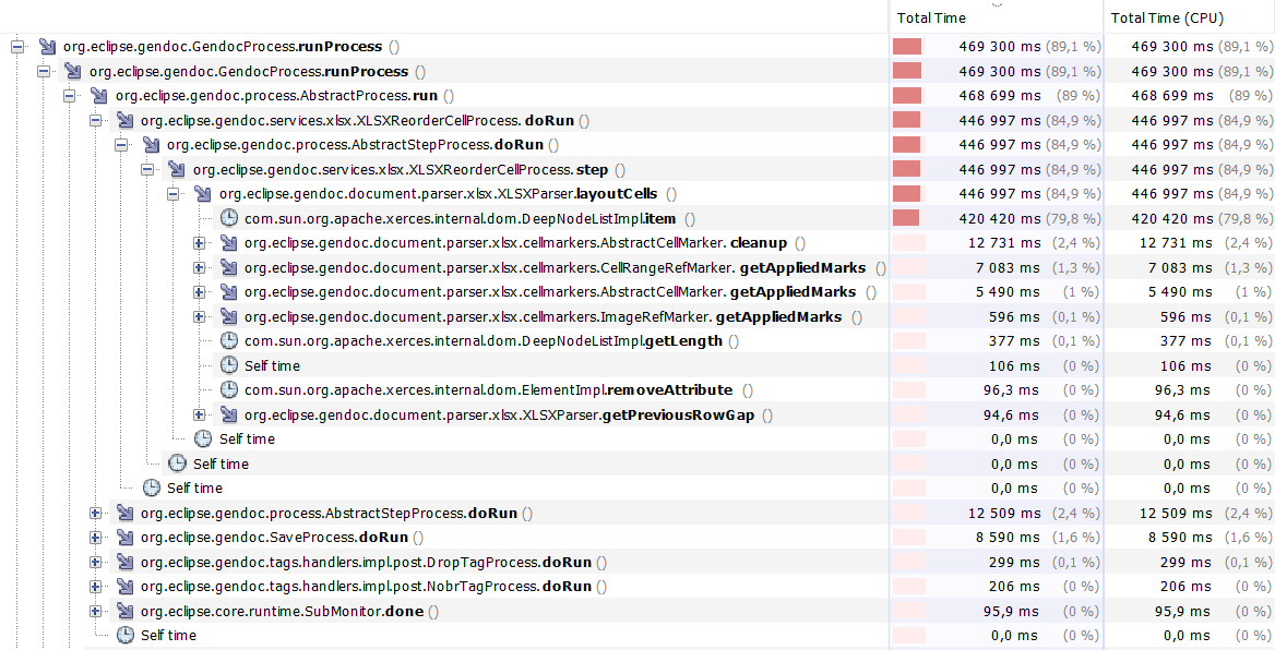

Re: XLSXParser::layoutCells() performance issue [message #1848249 is a reply to message #1848248] Thu, 25 November 2021 23:27 Go to previous messageGo to next message
The following code works fast enough:
        Node sheetData = getDocument().getElementsByTagName("sheetData").item(0);
        for (Node node = sheetData.getFirstChild(); node != null; node = node.getNextSibling()) {
            if (!(node instanceof Element)) {
                continue;
            Element row = (Element) node;
index.php/fa/41376/0/
It seems that cleanup() and getAppliedMarks() methods can be improved too. They evaluate the followin XPath expression:
XPathXlsxUtils.evaluateNodes(xlsxParser.getDocument(),"//:row/:c/gendoc:mark[@id='"+this.mark+"']")
Maybe I'm wrong but it seems that addition of :sheetData to the expression:
XPathXlsxUtils.evaluateNodes(xlsxParser.getDocument(),"/:sheetData/:row/:c/gendoc:mark[@id='"+this.mark+"']")
reduces time taken by layoutCells() from 27 seconds to 17 seconds. Maybe the XPath could be replaced by a loop over all rows...

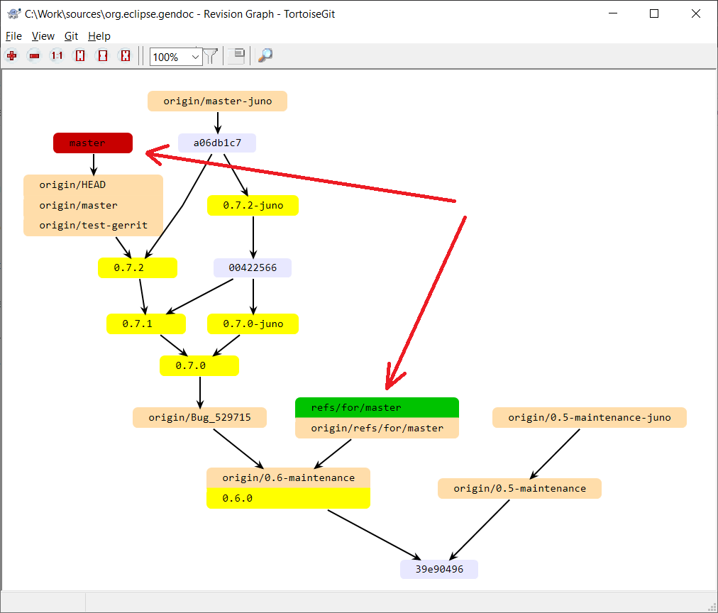

Re: XLSXParser::layoutCells() performance issue [message #1848448 is a reply to message #1848445] Thu, 02 December 2021 06:36 Go to previous messageGo to next message
I get the following error when trying to push to master:
git.exe push -v --progress "origin" master:master
Pushing to ssh://git.eclipse.org:29418/gendoc/org.eclipse.gendoc
Enumerating objects: 27, done.
Counting objects: 100% (27/27), done.
Delta compression using up to 16 threads
Compressing objects: 100% (8/8), done.
Writing objects: 100% (14/14), 1.51 KiB | 1.51 MiB/s, done.
Total 14 (delta 7), reused 0 (delta 0), pack-reused 0
remote: Resolving deltas: 100% (7/7)
remote: error: branch refs/heads/master:
remote: To push into this reference you need 'Push' rights.
remote: User: dnikiforov
remote: Contact an administrator to fix the permissions
remote: Processing changes: refs: 1, done
To ssh://git.eclipse.org:29418/gendoc/org.eclipse.gendoc
! [remote rejected] master -> master (prohibited by Gerrit: not permitted: update)
error: failed to push some refs to 'ssh://git.eclipse.org:29418/gendoc/org.eclipse.gendoc'
I don't have enough rights.
If I understand everithing right I should push to refs/for/master instead. But I get the following error:
git.exe push -v --progress "origin" master:refs/for/master
! [rejected]        master -> refs/for/master (non-fast-forward)
hint: Updates were rejected because a pushed branch tip is behind its remote
hint: counterpart. Check out this branch and integrate the remote changes
hint: (e.g. 'git pull ...') before pushing again.
hint: See the 'Note about fast-forwards' in 'git push --help' for details.
refs/for/master points to version 0.6.0. I guess it should point to HEAD or 0.7.2.
index.php/fa/41410/0/
I think that refs/for/master is the only branch for which I have push rights.
