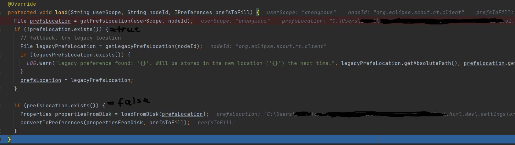

Thanks for your reply.
So what i could see is that when i change something on the table, the change gets saved in the .prefs file. I could confirm that by checking the file and also the method flushToDisk() was called correctly. It was also saved to the right .prefs file for that specific user.
Now what i could observe is when i log out and back in again. The load method gets called but with a userScope of annonymous. Also the load method in my case doesnt do anything cause it seems it can´t find my .prefs and uses the legacyPrefs which also doesnt exist. Then after load() is done, the flushToDisk method is called, and flushes the default .prefs to the specific user .prefs.
I tried to screenshot it:
index.php/fa/41281/0/
Do i have to do something? Maybe set the correct UserScope on login?

Ok so i found the problem. It is related to this post i did some time ago:
https://www.eclipse.org/forums/index.php/t/1109076/
But basically the problem was that i initialized the shared variables after i initialized the ClientUIPreferences. Thats why it was annonymous. So i just moved the
    String localeString =
      ClientUIPreferences.getClientPreferences(get()).get(PREF_USER_LOCALE, null);
to after i initialize the shared variables.
Thanks for the help :)
