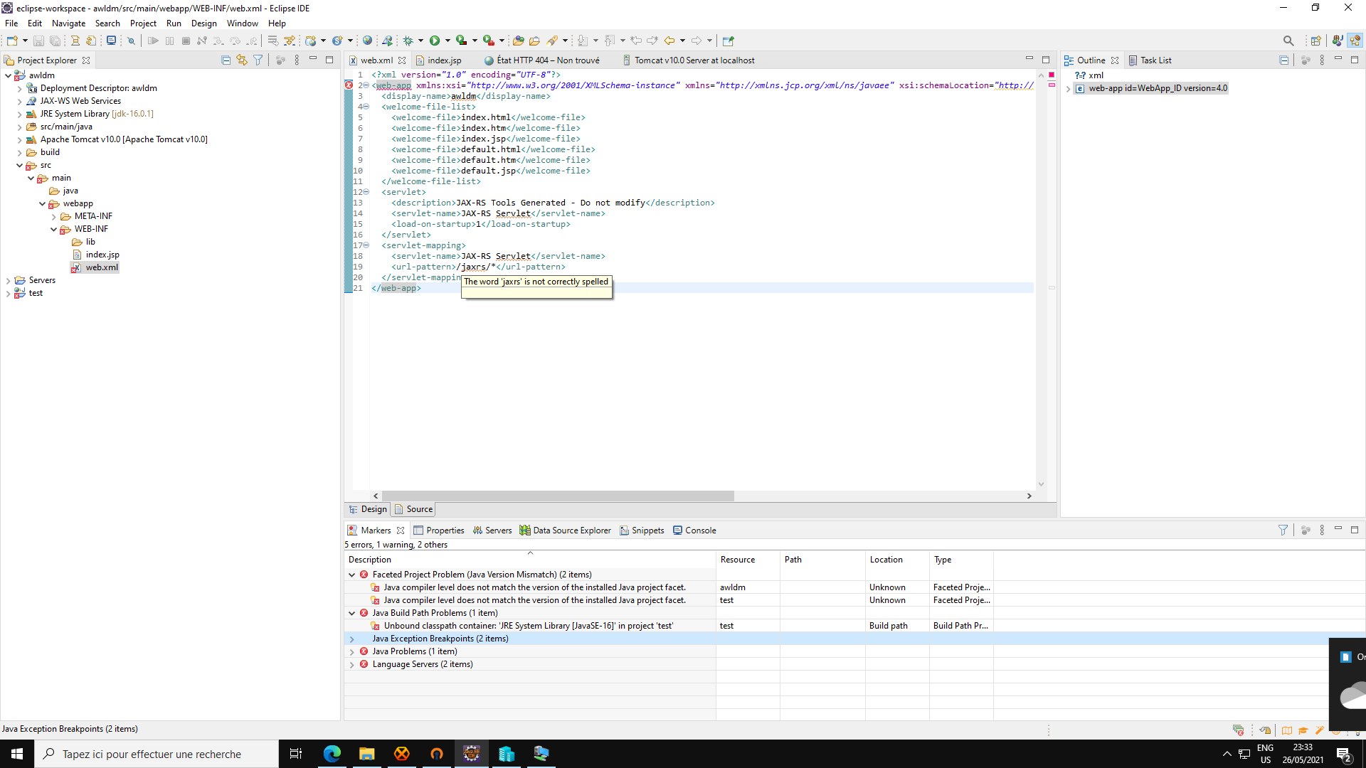

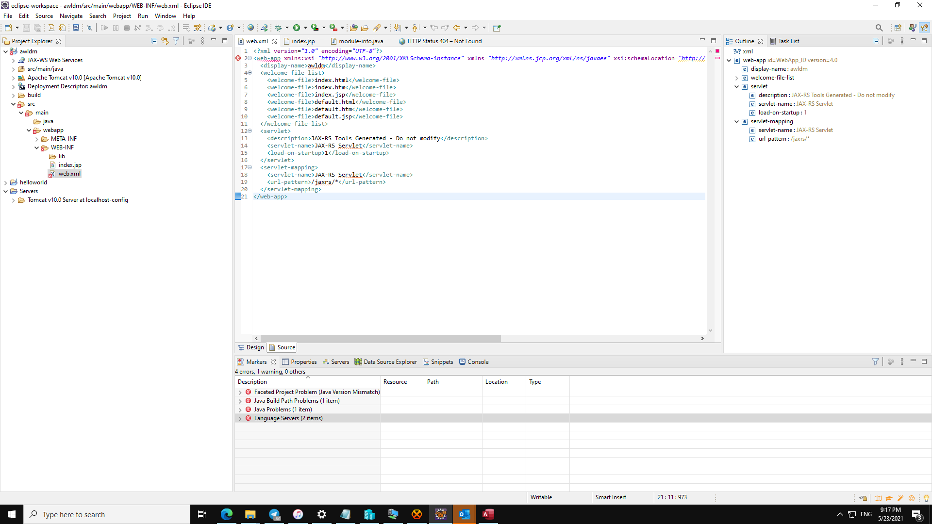

I started a Dynamic Web Project using Java EE Perspective. I get the following errors, please see image attached.
Re: Errors starting out [message #1841630 is a reply to message #1841629] Sun, 23 May 2021 22:44 Go to previous messageGo to next message
You've collapsed all of the type categories in the Problems view, hiding the actual error descriptions. For one, though, it looks like your project doesn't
have a JRE on its Java Build Path.

thank you, I was able to fix one of the errors in the original xml by adding tomcat to the build path but I still have the following errors showed in the screen shot.

Again, the contents of your Problems view are collapsed, so there's no way to read the messages in there. Those messages are there to help you fix problems
before you launch the Tomcat server, and indicate reasons why things would misbehave if you launched the server anyway. This is going to be a very long
and slow to progress thread if you keep ignoring them.

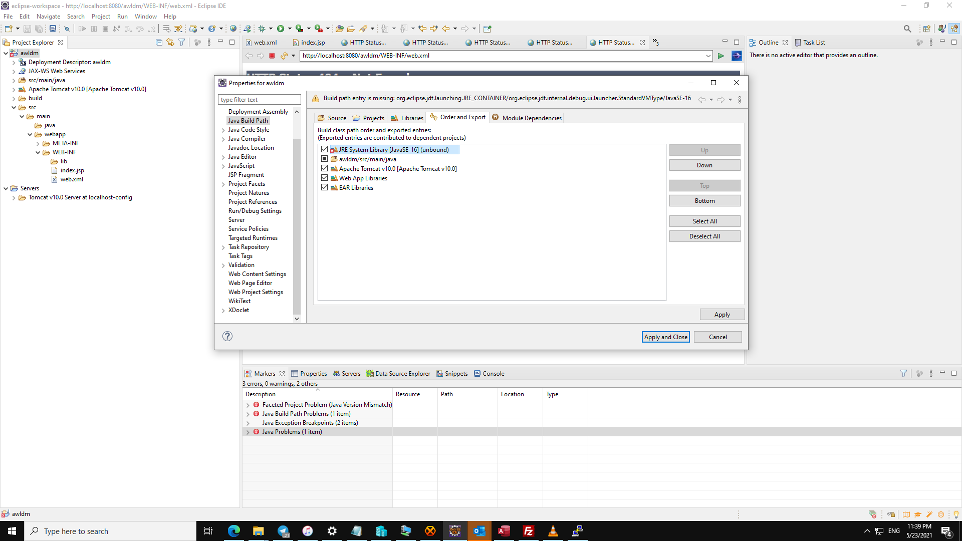

The dialog you are showing shows that you don't have a Java 16 JRE correctly set up in your Installed JREs preference page. Go do that first. Then open the
project's Properties dialog (select the project and either right-click or use the Project menu in the menu bar), go to the Project Facets page,
and make sure the version of the Java facet matches a version from the Installed JREs preference page that you want to use, whether it's 16 or not.

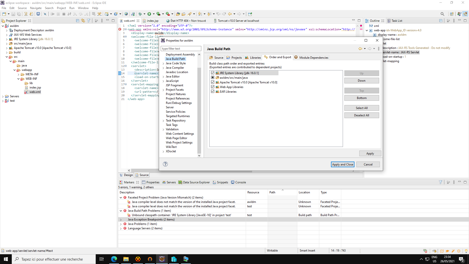

As far as the Web-inf this is the default from Eclipse, it is supposed to work and compile. It is marked as the Deploy Path.
I still have 4 errors and not sure how to address them. I added JRE 16 to the build path. I find it frustrating since I recently installed Java 8 and not clear why Java 8 is necessary and Java 16 but I also reinstalled Eclipse after since it threw an exception. One is perhaps the runtime environment and the other is the development kit?
I took a bunch of screen shots.
so hopefully this can help you be able to give me an indication of how to get started...

Java compiler does not match the version of the installed Java project facet.

For the first image, it's a matter of "jaxrs" being flagged by the Spell Checking. You can use Ctrl+1 with the cursor
in the word to remedy that message, or pursue other options through the Spelling preference page.

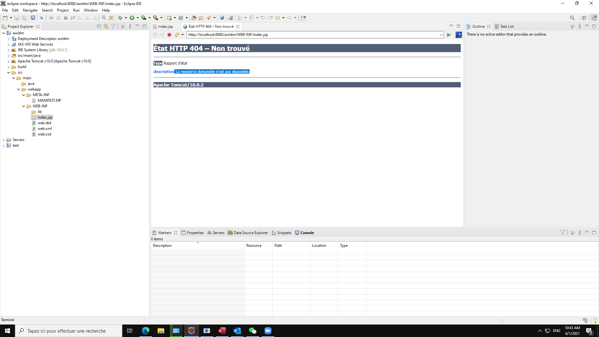

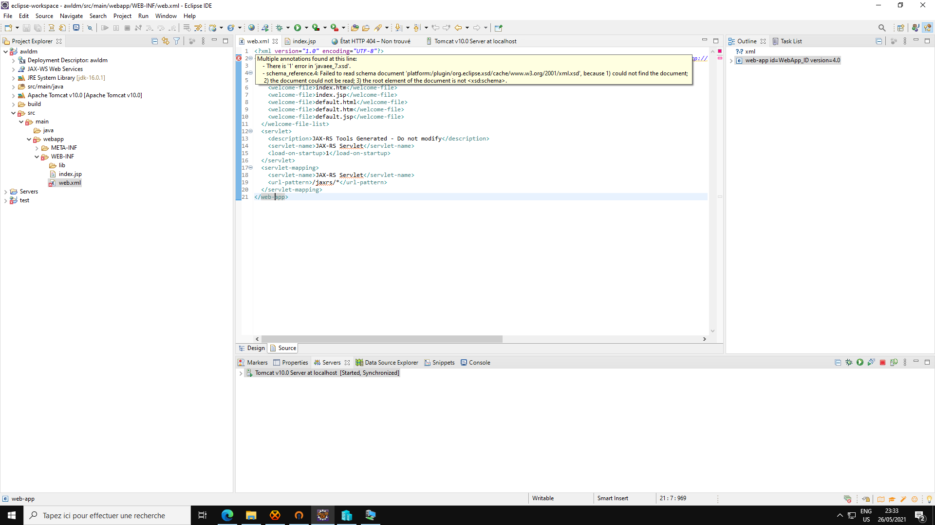

For the second image, I'm guessing it's the same as https://github.com/eclipse/lemminx/issues/1042 (LemminX being a Language
Server). The Dynamic Web Project is still the project type to use for Java-based web apps, and it doesn't tend to start you out with
a web.xml file that wouldn't pass basic XML validation.

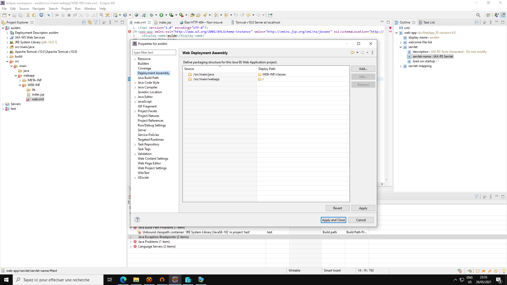

The third image shows the message "Java compiler does not match the version of the installed Java project facet" , related to the
Project Facets property page shown elsewhere in the Properties dialog. The Facets indicate what features your project contains
and helps make sure you are deploying to a runtime that can support all of that. As I understand it (which could be wrong), changing
the Java facet version sets the project to try and build against that version of the JRE (pulled from what's in your Installed JREs
preference page) as well as sets the Compiler settings for the project to use that version of the language. I've not been the biggest
fan of tying these together, for multiple reasons of late, but the message is telling you that the value on the Project Facets property
page isn't the value set on your compiler settings. You can reconcile the discrepancy using either the Project Facets or Java
Compiler property page in the dialog you're showing.

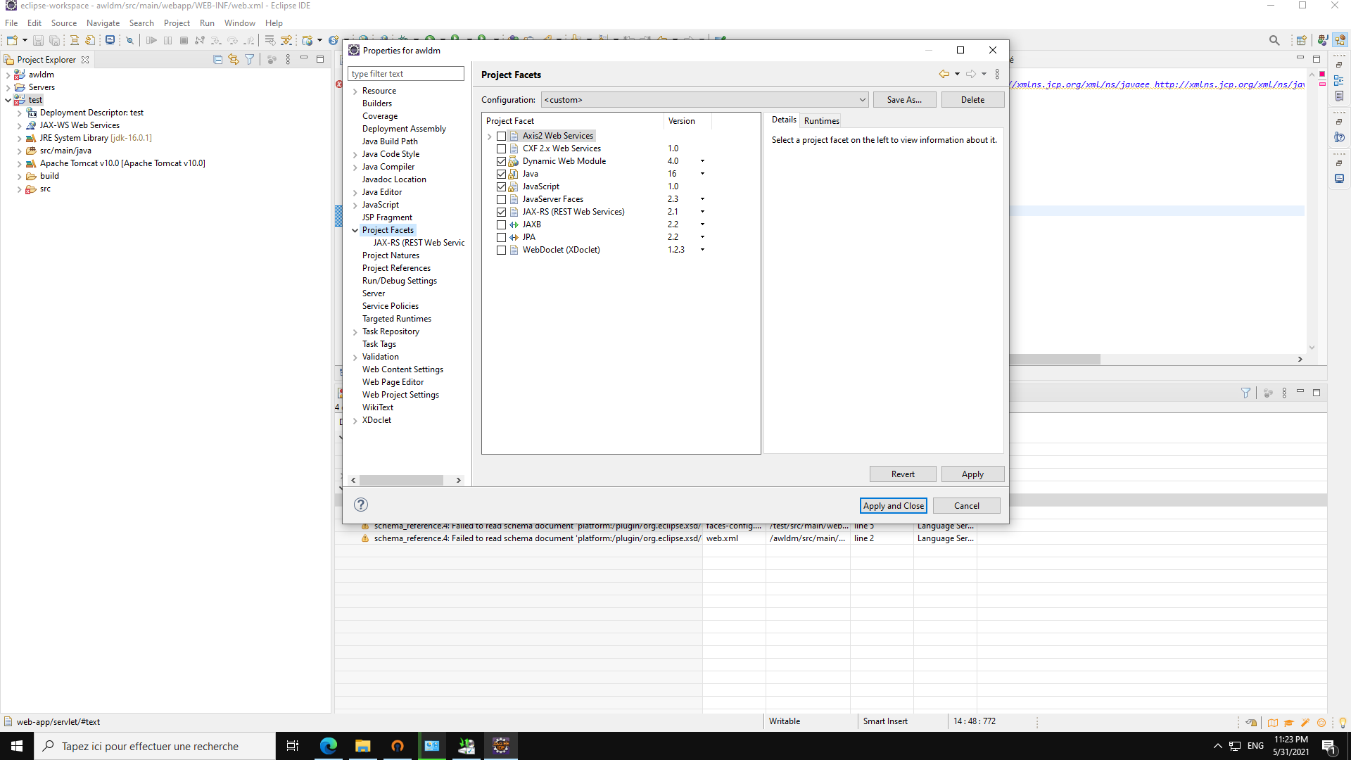

I'm not sure what the fourth image is supposed to show, but I did change up the default paths in 2021-03 to make it easier to migrate
the project to use headless build systems later on. If you want the previous values, you just need to fill them in in the wizard that
creates the project. The new values aren't wrong, they're just different from the old values.

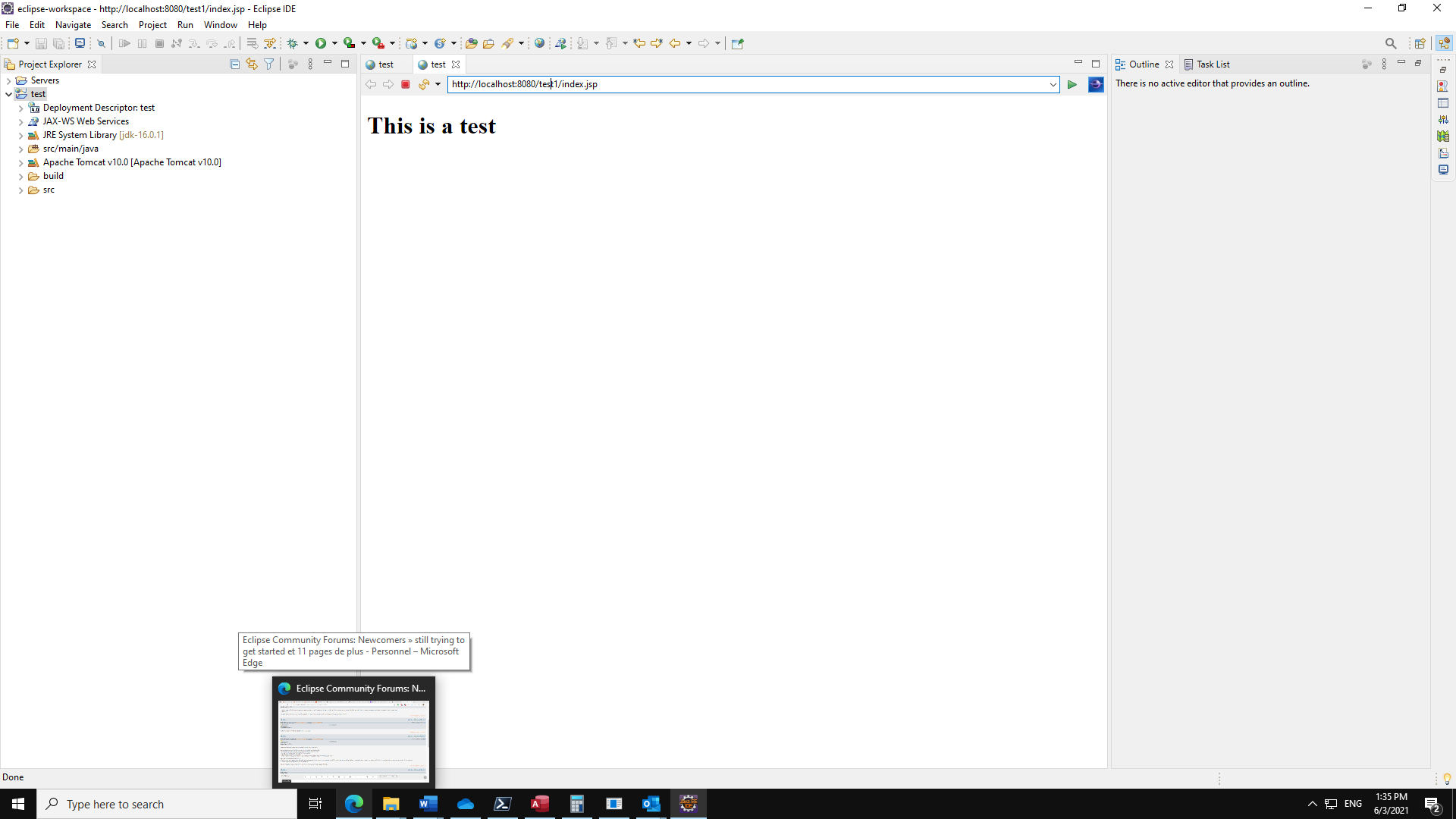

I got rid of the errors but I still don't have the Tomcat at the source target... should I create a new case? basically I want that Tomcat executes the index.jsp to start this off...
Re: Errors starting out [message #1841870 is a reply to message #1841869] Tue, 01 June 2021 11:39 Go to previous messageGo to next message
As I said before, the contents of the WEB-INF folder are not directly retrievable by a web client. That includes a WEB-INF/index.jsp. Move it outside of WEB-INF.

Re: Errors starting out [message #1841930 is a reply to message #1841914] Thu, 03 June 2021 13:36 Go to previous message
worked
