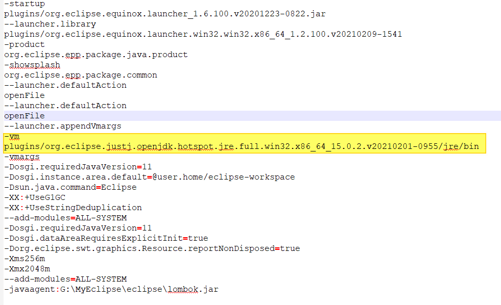

Fresh unzip of eclipse-java-2021-03-R-win32-x86_64.zip and fresh work space.
This is my eclipse.ini :
index.php/fa/40182/0/

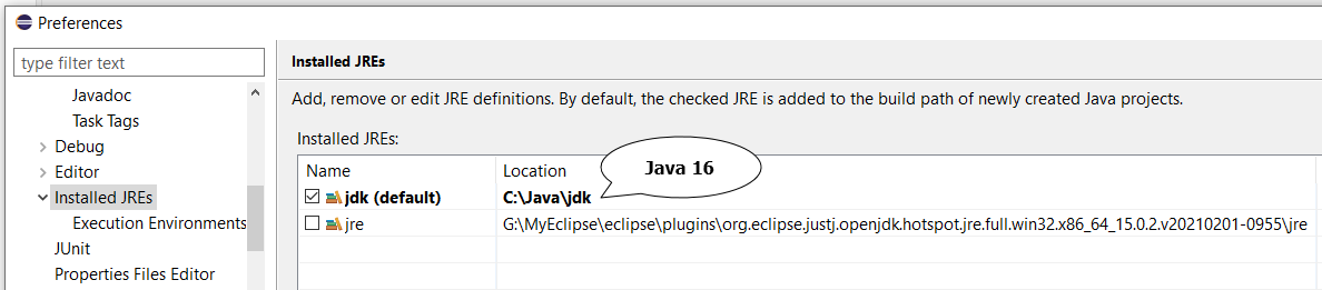

I installed Java 16 Support for Eclipse 2021-03 (4.19).
Later I add java 16 manually (openjdk-16_windows-x64_bin.zip):
index.php/fa/40183/0/

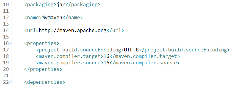

In the project I change the pom.xml and alt-F5 to update the project.
index.php/fa/40184/0/

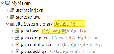

The result:
index.php/fa/40185/0/
