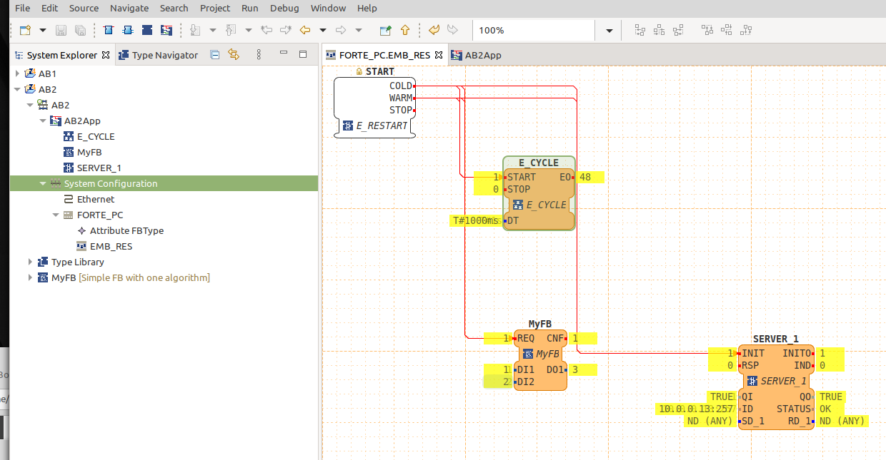

I wish to recive a simple TCP/IP message, (see picture)
I have a python program sending every second a message
on the RTE I get this ?
CBSDSocketInterface: bind() failed: Permission denied
No Idea where to go from here ?,
Is it something I am not setting on the SUBSCRIBE_1 Fb ?
Thank you
Asterios

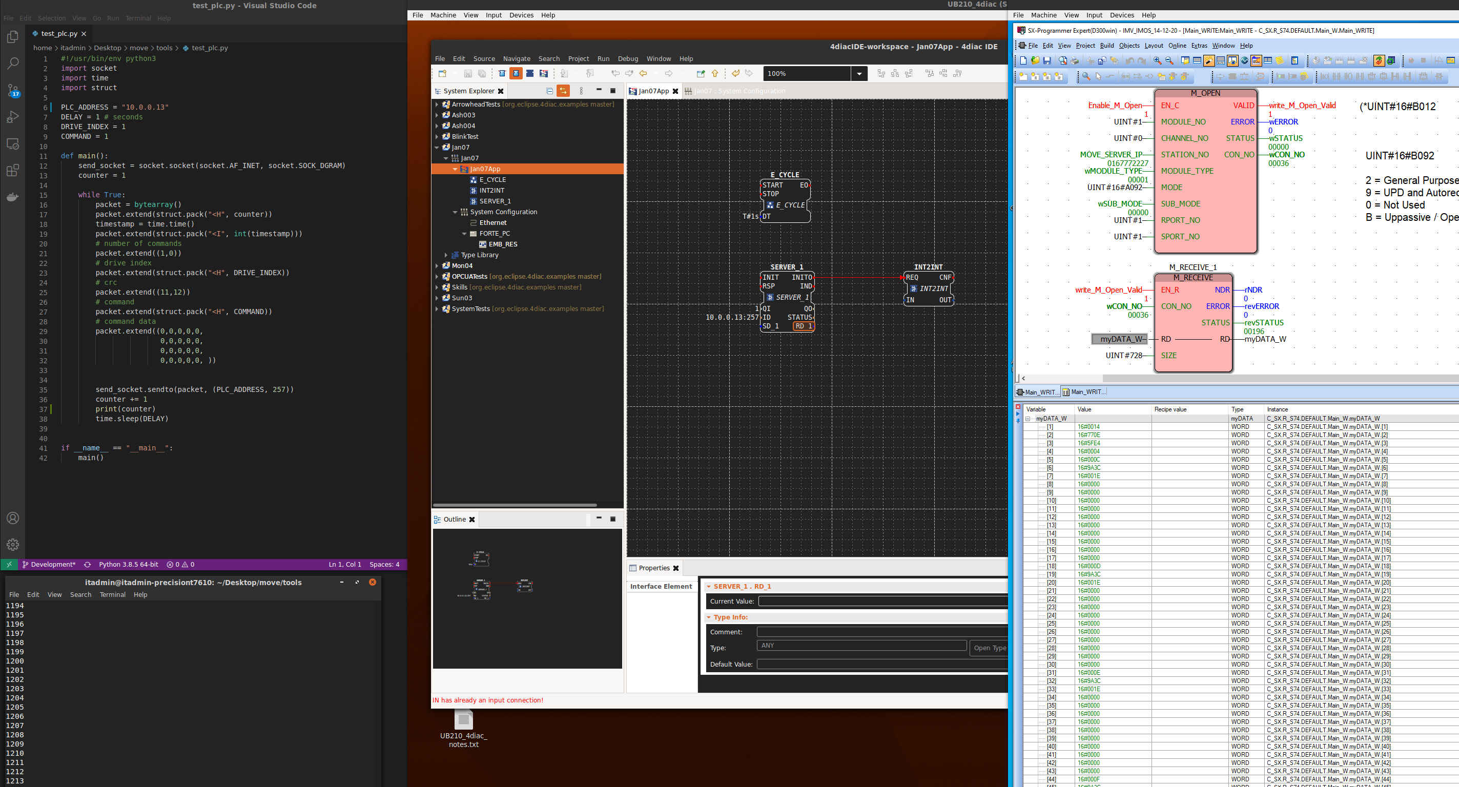

1/ How do I know its working ? Having probem decoding RD_1, from previous message how do I attached a word array ?
Like IEC1131 can I have global word arrays and attached it to the RD_1 pin ?

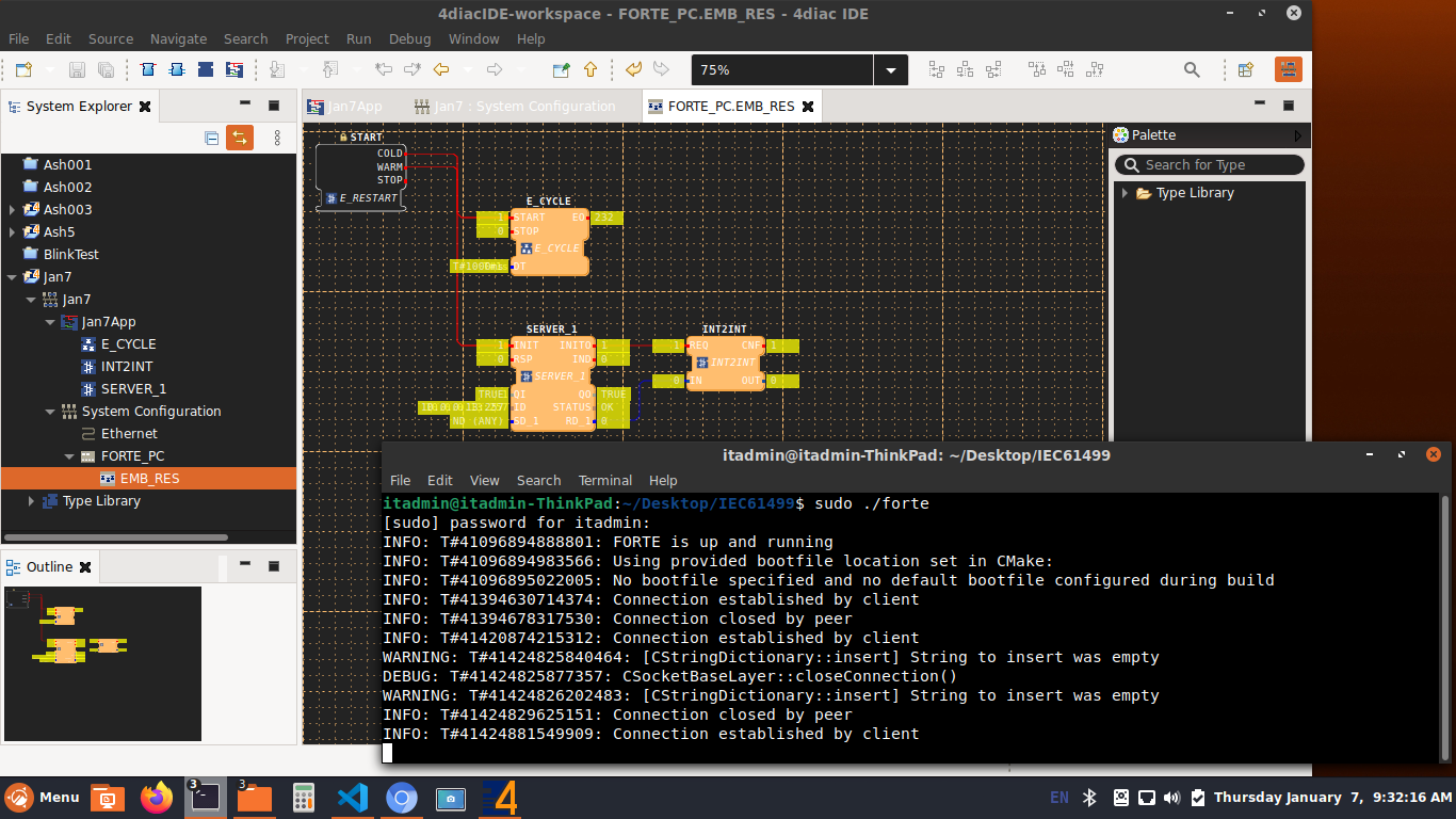

Screen shot 1, RTE and IDE running on my laptop, RTE working properly ? what is that error message ?
2/ On my Desktop PC, could not connect th server FB RD pin to the INT2INT ? both running ubuntu 20 10.
screen shot 2 also shows python program sending out a TCP/IP message and a example of a Fuji PLC recving a TCP/IP message in a word array,
Also the IDE that can't connect Pins.
Again, apprechiate the suport
Asterios

However I'm concerned that you are not able to do data connections? Are you running on 4diac IDE 1.13.0? Are your FBs mapped? If yes please unmap them first and remap them. We have a minor issue that slipped trough. Will be fixed in 1.13.1 coming out hopefully next week.
The messages in your 4diac FORTE console are perfectly fine. They are mostly debugg messages for 4diac FORTE developers.
In order to configure your Server FB to expect WORD arrays. You need an FB with a WORD array input. The data format for sending word arrays is explained in the link [1] from my last post.
I hope this helps.
Alois

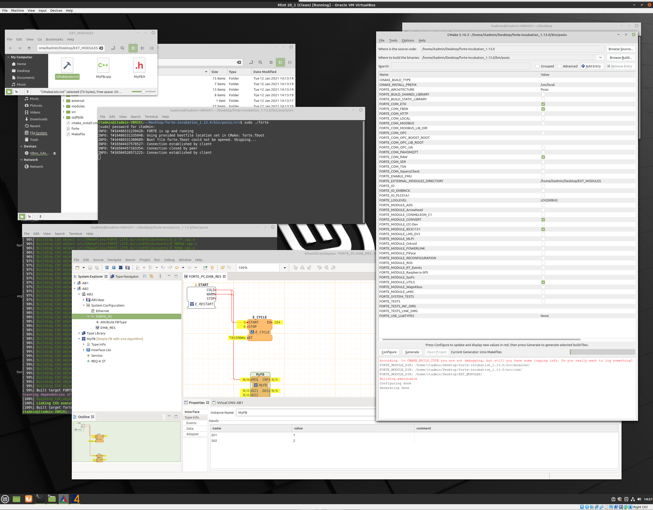

Re: Subscribe_1 [message #1836678 is a reply to message #1836646] Mon, 11 January 2021 23:04 Go to previous messageGo to next message
Hi Alois
Thank you for your recommendations, using cmake gui now,
See attached screen shot ,
managed to use cmake gui to make FORTE (using latest 1.13)
included my FB
Still on the IDE shows N/A
a bit lost where to go now ?
Asterios
Re: Subscribe_1 [message #1836685 is a reply to message #1836678] Tue, 12 January 2021 02:41 Go to previous messageGo to next message
Hi Asterios,
Thanks for the screenshot this really helped me to find the issue. The problem is that the external modules directory can not directly hold one module. The intention is to have there one or more module subdirectories. So you should create at your ext_mod a further directory with your fblib and put there your cpp, h, and cmakelist.txt. With that in CMake gui after running Configure again a new FORTE_MODULE_yyyy will apear (should be marked red and on the top. By activating this module your FB will be added to your 4diac FORTE.
I hope this helps,
Alois
PS: In 4diac IDE there is a Deployment console view (window->show view->others...->4diac IDE->Deployment Console) this will show you the deployment process and any errors during deployment. There you should have gotten the error message unsupported type. This would hint that your type is still not in your self built 4diac FORTE

Hi Alois
Deleted the VM and started again, this time it all worked
Thank you for your support
