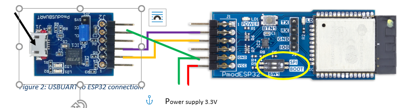

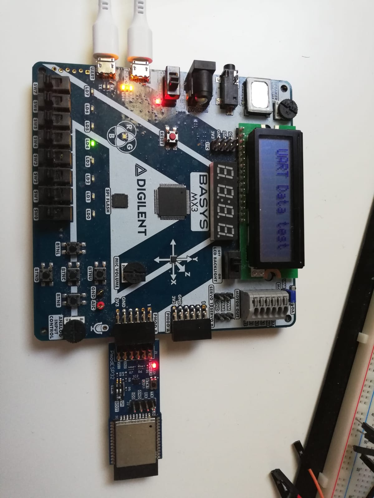

I have an issue with setting the MQTT User Configuration using the Basys MX3 in combination with an ESP32 wifi module

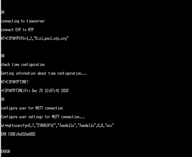

Everytime when I try to run my program it shows this message as error
index.php/fa/39618/0/
the errorcode is 0x010a6002 and from what I found on this site
esspressif.com
it means that it is not in a configured state. The strange thing is when I try to manually type in the configuration in teraterm I get don't get this problem and I can connect just fine to the broker. This is the broker I am using right now mqtt.eclipseprojects.io/mqtt. I am kind of stuck for a few days now and I couldn't really find a concrete solution for this. I would like some help with it.

This is the set-up when trying to run the programm automatically:
index.php/fa/39620/0/
It connects to the network protocol just fine, but when executing the function to set usercfg I get the errorcode you see in the first png.

This is the function where I try to setting the userconfig:
//configure user settings for MQTT connection
void config_user(unsigned int linkID, unsigned int scheme, char *ClientId, char *username, char *password, unsigned  int cert_key_ID, unsigned int CA_ID, char *path) {
    printString("Configure user settings for MQTT connection...\r\n");
    char tx[0];
    sprintf(tx, "at+mqttusercfg=%d,%d,\"%s\",\"%s\",\"%s\",%d,%d,\"%s\"\r\n", linkID, scheme, ClientId, username, password, cert_key_ID, CA_ID, path);
    sendToESP(tx);
    delayMS(20);
    while(!(UART1_StatusGet() & UART1_RECEIVER_IDLE )) {
           // Wait for the data to fill the RX buffer
    char rx[RX_BUF_SIZE];
    char * cur = rx;
    while(UART1_ReceiveBufferSizeGet() < 512) {
        *cur++ = UART1_Read();
    *cur = '\0';
    printString(rx);
I'd really appreciated if someone could help me with this. I personally think it has to do with login creditentials but i am not sure about this.
