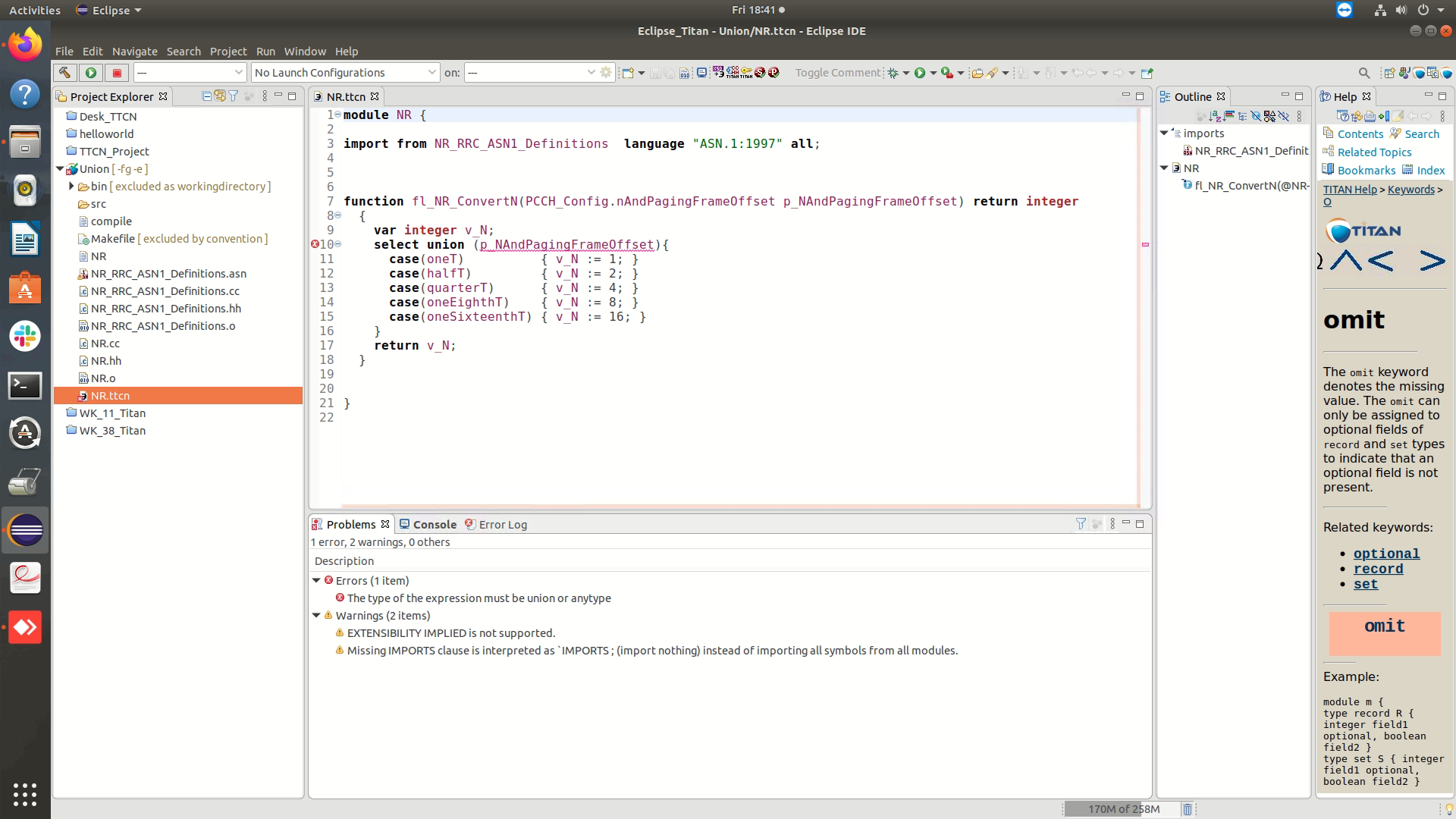

Re: The type of the expression must be union or anytype [message #1833545 is a reply to message #1833480] Fri, 16 October 2020 07:38 Go to previous messageGo to next message
Hi ,
The example scenario is as follows.
$ function fl_NR_ConvertN(PCCH_Config.nAndPagingFrameOffset p_NAndPagingFrameOffset) return integer
    var integer v_N;
    select union (p_NAndPagingFrameOffset){
      case(oneT)          { v_N := 1; }
      case(halfT)         { v_N := 2; }
      case(quarterT)      { v_N := 4; }
      case(oneEighthT)    { v_N := 8; }
      case(oneSixteenthT) { v_N := 16; }
    return v_N;
The above union is imported from the following ASN.1 module ( import from NR_RRC_ASN1_Definitions language "ASN.1:2002" all with {encode "UNALIGNED_PER_OctetAligned"};) and it is as follows.
 $  PCCH-Config ::=             SEQUENCE {
    defaultPagingCycle                  PagingCycle,
    nAndPagingFrameOffset               CHOICE {
        oneT                                NULL,
        halfT                               INTEGER (0..1),
        quarterT                            INTEGER (0..3),
        oneEighthT                          INTEGER (0..7),
        oneSixteenthT                       INTEGER (0..15)
When I am building this code, I am getting the error "The type of expression must be union or anytype".
Can you please let me know how to solve the issue.

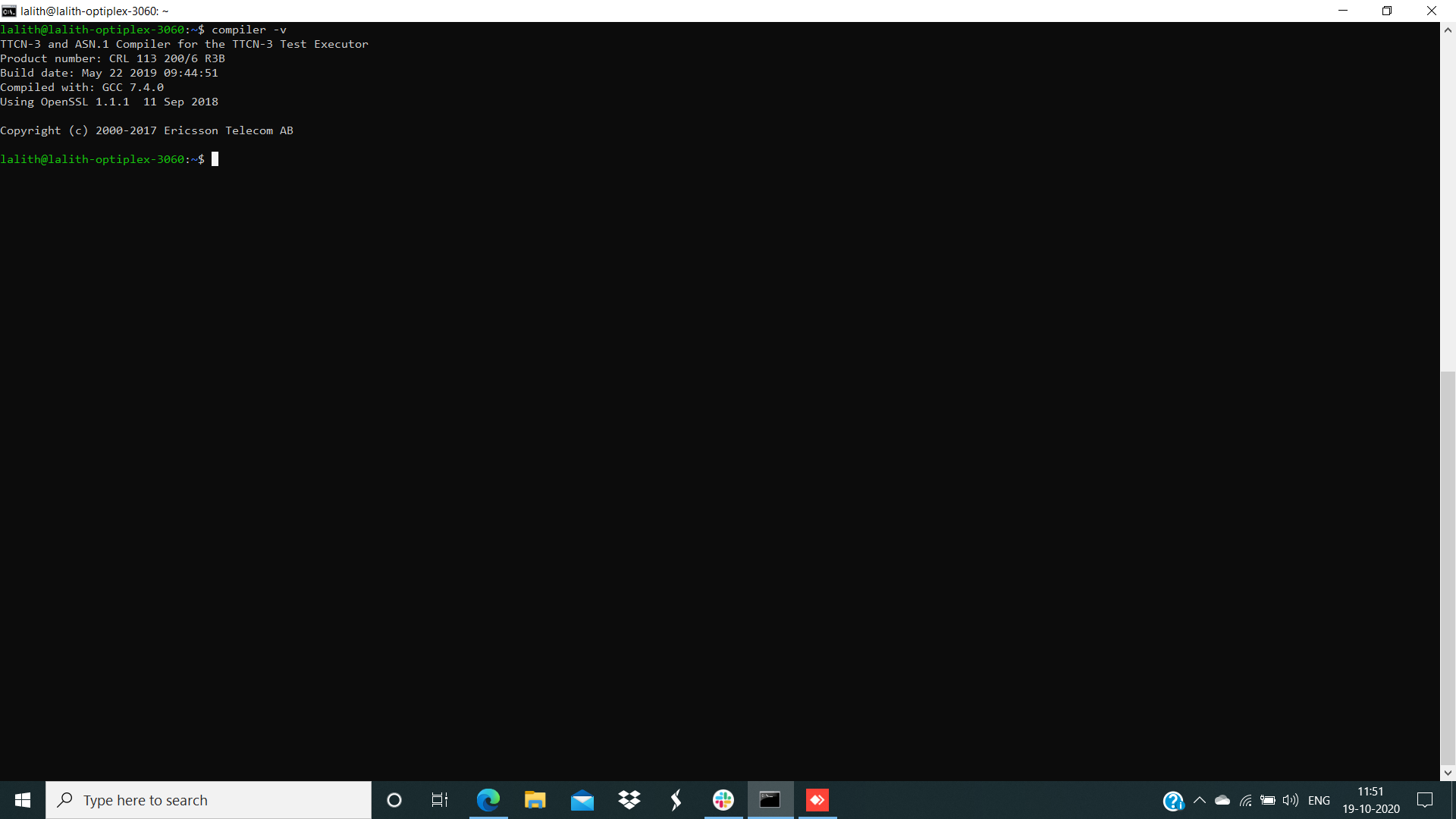

Re: The type of the expression must be union or anytype [message #1833579 is a reply to message #1833575] Mon, 19 October 2020 02:25 Go to previous messageGo to next message
Hi Elemer,
I have done the same to check the complier version using compiler -v.
The screen shot is attached below.
Best regards
Lalithaditya Naidu
Re: The type of the expression must be union or anytype [message #1833581 is a reply to message #1833579] Mon, 19 October 2020 02:32 Go to previous messageGo to next message
Hi Gajula,
Yes, you have version /6 R3B,
That is 6.3.1;

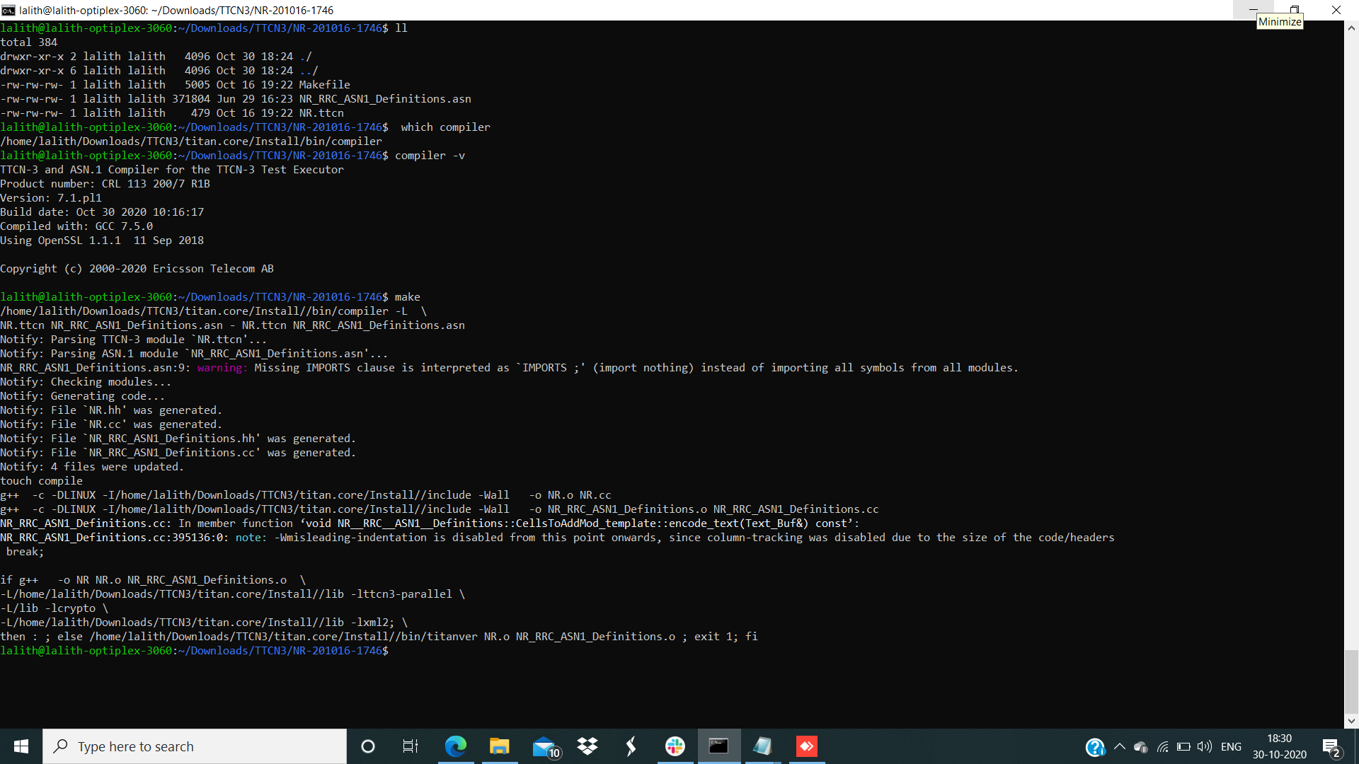

Re: The type of the expression must be union or anytype [message #1833863 is a reply to message #1833774] Mon, 26 October 2020 11:05 Go to previous messageGo to next message
Hi Elemer
I have downloaded 7.1.1 from github and installed it as per the instructions.
The GCC is upgraded to 7.5.0 and the compiler -v also changed to 7.1.1 ( CRL 113 200/7 R1B, 7.1.pl1 ).
But the problem ,The type of the expression must be union or anytype is still present.
Thanks and regards
Lalithaditya

Re: The type of the expression must be union or anytype [message #1833880 is a reply to message #1833877] Mon, 26 October 2020 15:27 Go to previous messageGo to next message
HI Gajula,
here's my console log for 7.1.1:

I have also tried 7.1.0 and 6.6.0 and those work as well.
So I suggest you remove every Titan install form your machine and start from scratch with 7.1.1.
I suspect you are somehow still engaging 6.3.1 which gives you the same error again and again.
BR
Elemer

I completely removed the compiler version 6.3.1 ,The results of the compiler and make for the sample code you shared is attached below.
I still find the error in the eclipse when i open the project.
Best Regards
Lalithaditya

Hi Gajula,
OK, it's the first time I hear about the Eclipse plug-ins being involved; so far you led me believe that you are working with the compiler on command line only.
So here's the situation: the Eclipse plug-ins can be used in a number of modes, but let's focus on one mode only,
namely them playing the role of an IDE as a front-end to the TTCN-3 compiler and executor (a.k.a. "compiler").
Now the compiler and the Eclipse part have independent syntactical/semantical analyses; so even of the Eclipse plug-in indicates
an error, that has no influence over the compiler. Which means you should simply disregard the error indication; it will have no effect
on the build performed by the compiler.
Of course , the compiler can be used in complete stand-alone mode, without the IDE (possibly paired with an editor that supports TTCN-3),
and many users prefer this mode.
(BTW, the error has been fixed in the latest version of the plug-ins that will be available soon; but this should not influence what you are doing).
