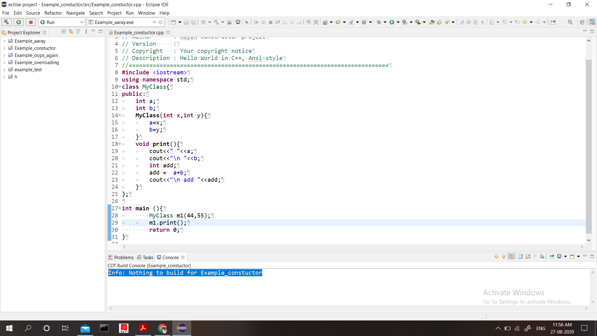

Re: "Nothing to build" problem [message #1831704 is a reply to message #1820796] Thu, 27 August 2020 02:28 Go to previous messageGo to next message
hi sir,
i am using eclipse latest 2020 v In which i make program but last output is always coming and new project not give output.
i hope you solve as early as possible

Info: Nothing to build for <project> from the internal builder
means the executable is newer than the source.
If you were using the external builder you would get something like
make: Nothing to be done for 'all'.
Try doing a clean then a build.
If that doesn't work then get back to us.
