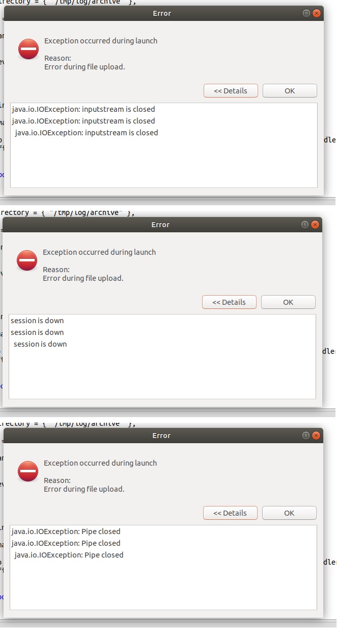

Hoping someone has some insight here. We've got two systems here, one is a Wandboard (commercial product) and one is our in-house hardware. Both are designed around the i.MX6, which is probably irrelevant. The Wandboard came with its own build of Linux (poky), we've rolled our own for our hardware. We've had builds on our hardware that have debugged before, unfortunately we lost our Linux guy, and the current build results in failures to upload (see attached screen snips). We can always debug on the Wandboard, it has never failed to work. So I'm sure this isn't a configuration issue on the Eclipse machine. There must be something that Eclipse needs on the target machine in order for it to push and debug on the remote. I have no idea what that something is, however.
index.php/fa/34434/0/
Also, below are the error messages in case anyone needs to search for this some day.
Thanks in advance.
Error during file upload.
java.io.IOException: inputstream is closed
java.io.IOException: Pipe closed

Follow up :
We were able to solve this problem. It appears sftp and sftp-server are required for Eclipse to copy data over to the target system. They were not part of our build. We added them manually, and it seems to have solved the problem.
If you're experiencing this issue, make sure you have the following installed on your target system :
/usr/libexec/sftp-server
/usr/bin/sftp
/usr/bin/gdbserver
/usr/lib/libstdc++.so.6
