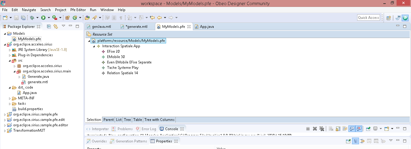

I am developing a M2T generator in Acceleo (in Obeo Designer).
I have created my metamodel based on *.ecore (pfe.ecore ) and then I have created an instance model in runtime (MyModels.pfe) using Sirius.
Now I am trying to generate the java code of MyModels.pfe using Accelo -the class root is InterationSpatiale. -check the attachment-
I want to generate a *.java for each of my classes in the diagram
here is my generate.mtl file

  • Attachment: workspace.PNG
    (Size: 56.94KB, Downloaded 162 times)
