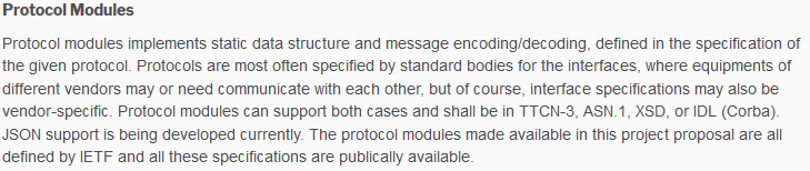

Re: Java code generator/executor of Titan [message #1828671 is a reply to message #1828017] Tue, 16 June 2020 06:31 Go to previous messageGo to next message
Hi Elemer,
i tried to figure out some stuff on my own, but there is a lot of documentation.
-the first thing you need to consider is the codecs your project assumes.
The Java code generator does not yet cover all codecs the legacy part does: only RAW is implemented, and JSON is on its way.
Are you refering to protocol modules mentioned here https://projects.eclipse.org/projects/tools.titan protocol modules:
index.php/fa/38338/0/Prot_Mod.png
As far as I understood correctly, those are specified by various templates?
The standard which I using specifies a lot of them. In a common template module i have a line importing some kind of lib:
import from XSDAUX language "TTCN-3:2012" all;
is there are source where I could obtain various common libs or are they part of the titan core git hub intallation?

Re: Java code generator/executor of Titan [message #1828682 is a reply to message #1828671] Tue, 16 June 2020 10:07 Go to previous messageGo to next message
Hi Jan,
protocol modules are structured representations of the messages expressed in TTCN-3 ( or ASN.1 etc. but let's stick to TTCN-3 for simplicity).
These structures are generic, but yes, specific templates can be generated based on them.
(For instance say there is a structure describing a message HELLO; by attributing certain values to different fields of this structure, a number of templates can be generated based on this structure)
Here
https://github.com/eclipse/titan.core
you can see a number of protocol modules listed ; and yes, these are the same ones as mentioned in https://projects.eclipse.org/projects/tools.titan. Protocol modules are stand -alone products, they have to be downloaded separately and are not part of the Titan installation itself.
Now the structures described by the protocol modules will have to encoded into a bitstream in order to be sent as a payload.
This can be done in a number of ways, depending on the representation of the payload:
-encoding in binary , also called as RAW encoding
-encoding in XML or JSON , wherever these formats are required (ultimately these are binary too, but with an internal structure according to XML or JSON specs)
-encoding in ascii ( or TEXT)
-binary encoding in BER/PER etc. for ASN.1
and so on
Encoding/decoding (that is back and forth conversion between the structured and binary representation ) can be done with purposely-written external functions
or using the capability of Titan to generate these codecs automatically;
to be able to do so , the TTCN-3 code has to be decorated with encoding instructions (which are non-standard) which will inform Titan about
how encoding/decoding should be done; Titan will process this info and generate the codec functions.
The legacy C/C++ Titan has a number of such supported codecs; the JAVA counterpart only supports RAW so far, and JSON is under construction.
We have published posts with detailed descriptions of the codecs, see earlier part of this forum,
and also the Titan reference guide, downloadable separately or packed with every Titan binary.
So you should look into your needs of protocol messages, see which protocol matches of the ones published so far.
If none, than you should write your own protocol module, which may be simpler or more complex task depending on the complexity of the protocol itself.
If there is a match you are in luck.
