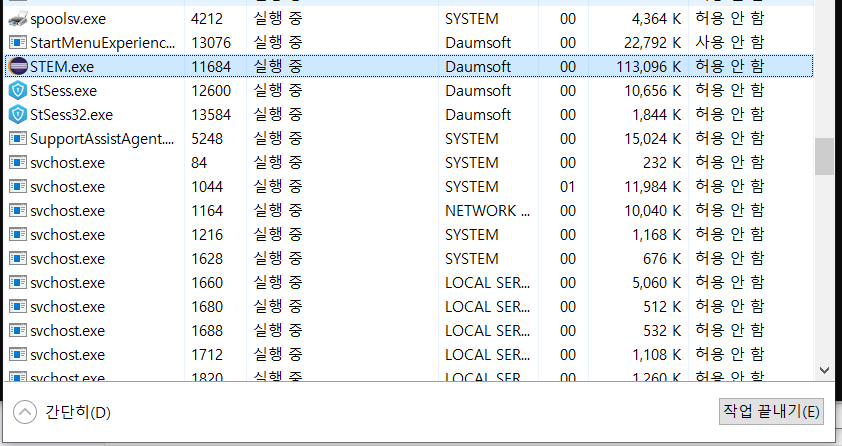

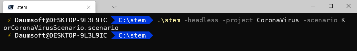

When i run headless, STEM Process is running but nothing happens. (see below).
