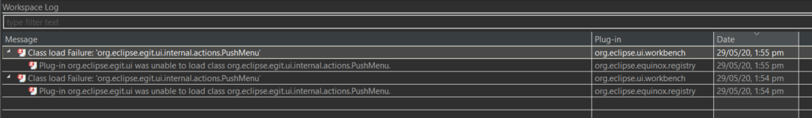

My eclipse and SAP ADT (ABAP Development Tools) are both updated to the latest version. Not sure what's wrong but, everytime I right click on any object or within any code, while in the ABAP perspective, I get this error (Attached).

EGit UI cannot load because EGit core cannot load because JGit crashes because the path to your HOME directory is utterly wrong.
You're on Windows. What are the values of the following environment variables:
%HOME%
%HOMEDRIVE%
%HOMEPATH%
%HOMESHARE%
What is the setting in Eclipse of system property user.home (should be shown in the Eclipse About Dialog, click "Installation Details", in the "Configuration" tab)?

Thanks for the reply. Here're the values in my system...
HOME=C:\Program Files\Git;C:\<myfolder>\eclipse;C:\Program Files\Java\jdk-11.0.6\bin;
HOMEDRIVE = C:
HOMEPATH=\Users\<myuser>
I don't have HOMESHARE setup.
In eclipse config, the user.home is set to my user folder C:/Users/<myuser>
PS: I just noticed that my eclipse is stored in "Eclipse" folder, whereas the HOME shows the folder as "eclipse". Do you think this is supposed to be case sensitive? Usually in windows it shouldn't matter, right?

Re: Errors in Eclipse 2020-03 with latest ADT [message #1828082 is a reply to message #1828079] Mon, 01 June 2020 01:39 Go to previous messageGo to next message
Yes.
Having a list of paths in %HOME% is highly unusual, if not wrong. Did you intend to set %PATH% to that list?
You could also fix it by setting %HOME% to C:\Users\<myuser>.

Thomas Wolf wrote on Mon, 01 June 2020 13:39
Wow.. awesome this simple step fixed the issue for me... In fact this also made git recognized in my VS Code, where it always showed as git not found.
Didn't know both the issues, were due to this one HOME path.
