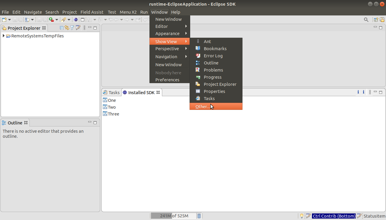

Re: Not able to add view to IDE [message #1828007 is a reply to message #1827981] Fri, 29 May 2020 01:09 Go to previous messageGo to next message
index.php/fa/38206/0/hi,
I am trying to create a sample view (windows > show view > sample view) for the existing plugin,
since i wanted to add a view to an existing plug-in, i edited the plugin.xml with the Manifest Editor, and in the Extensions tab i added Extension Templates by choosing Sample View.
Edited Plugin.xml :

I tried this procedure for new plugin and i was able to create the view (Image attached)
PS: Installed SDK is the view i have created.
Thank you.
Re: Not able to add view to IDE [message #1828021 is a reply to message #1828007] Fri, 29 May 2020 05:21 Go to previous messageGo to next message
Sorry for not providing the full details.
We are working on a custom IDE based on Eclipse CDT. It is required that a new "custom view" be added.
For instance:
​ Just like the red-colored "Installed-SDK view" in the image

Re: Not able to add view to IDE [message #1828025 is a reply to message #1828021] Fri, 29 May 2020 07:19 Go to previous message
You are trying to 'create an Eclipse view' (google around for many examples)
The code inside your InstalledSDKView class will never create a view, this is code for creating a standalone application.
