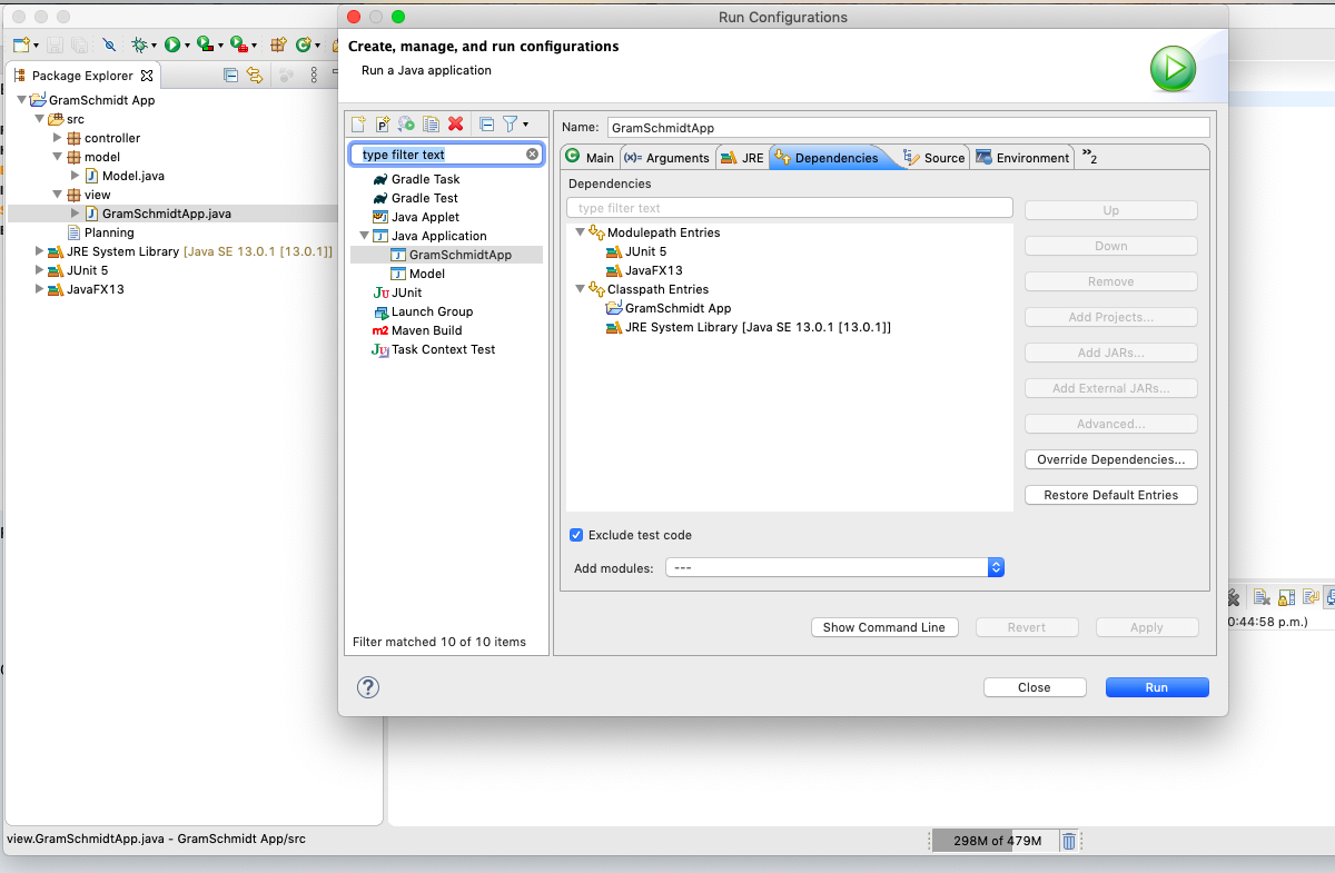

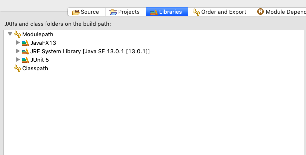

Ok I think I found one reason: I'm using VM arguments to get javafx to work:
--module-path "\path\to\javafx-sdk-13.0.1\lib" --add-modules javafx.controls,javafx.fxml
, and this doesn't get carried into the jar as Eclipse itself says. But how to solve that?
Essentially, perhaps the key to solving this problem is to have javafx working on Eclipse without the VM arguments.
I've heard about Maven but I don't quite know what it is nor how to use it.
Attached are screenshots that I hope can help someone solve the issue.

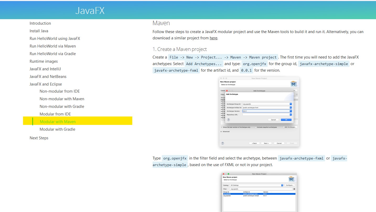

Install Maven and then follow this tutorial:
index.php/fa/37934/0/
https://openjfx.io/openjfx-docs/#IDE-Eclipse
The system will download the jars (dependencies) from Maven site and will store them in folder {user.home}\.m2\ .

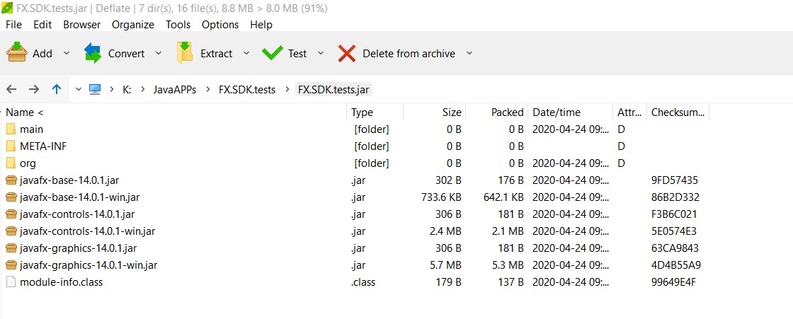

I was able to create a stand alone runnable jar using "Package required libraries into generated JAR"
This is the content of the jar:
index.php/fa/37935/0/
