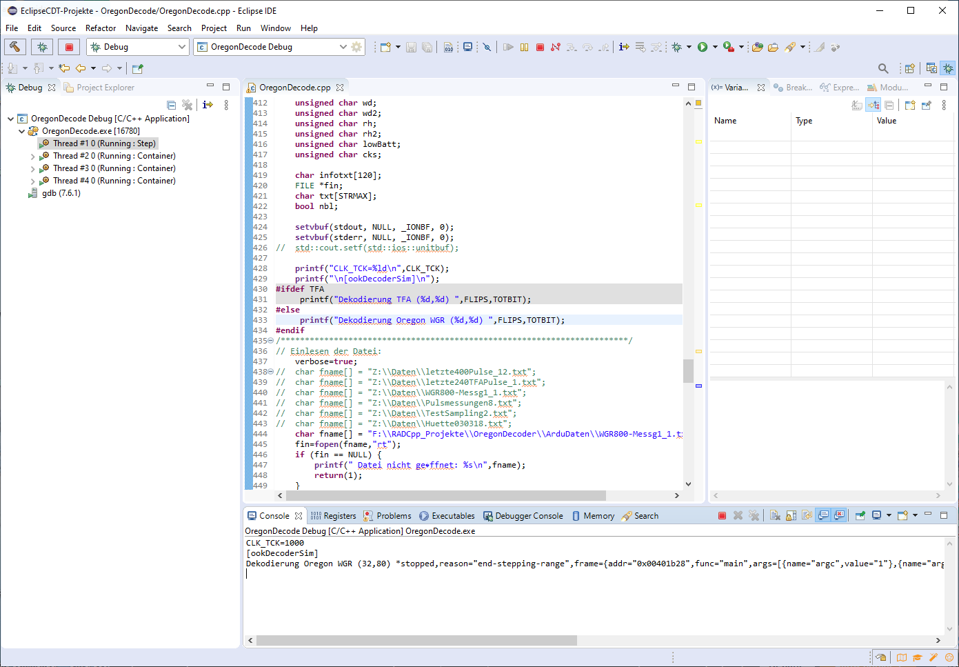

shows some outputs and then the debugger crashes. The only remaining control is terminating the program, see the attachment crashedDebugger.PNG.

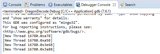

In the console tab you can see three lines of outputs. The output from program line 433 is visible, and in the same line the debugger reports an error "*stopped,reason="end-stepping-range", ..."
The content of the debugger console can be seen in attachment DebuggerConsole.PNG.
The debugger crashes only when I am stepping line by line over the printf statements. The debugger performs correctly when I run the program from breakpoint to breakpoint with the "resume" button.
