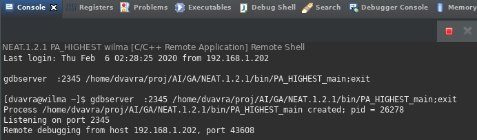

Well, I don't know then.
It works for me.
I did have a problem initially when the remote firewall blocked the port.
index.php/fa/37312/0/
