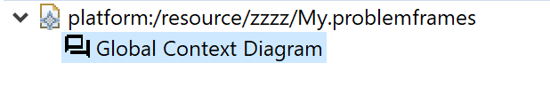

thank you for the answer and the hint to the other posts. I managed to create a session and a diagram.
However, I am stuck with one remaining thing. I want to create more than 1 representation for different objects.
What I get is that:
index.php/fa/37332/0/
My code should create a representation for "Global Context Diagram", but it does not. Why?

update:
Strange thing here is, that dialectmanager seems not to create a representation. Everything else works . Any hints are welcome again! Thx

Re: Create diagram programmatically [message #1822134 is a reply to message #1821021] Thu, 27 February 2020 11:54 Go to previous messageGo to next message
I just ran into a similar issue (and spent a lot of time in the debugger to find a workaround). Disclaimer: the following is true for Sirius 6.0.0 (which is a bit old), I didn't have the time to test a recent release yet.
So, first of all you have to know that when creating a Diagram Description (within a Viewpoint) you can set an Initialization flag (see the doc [1]). When a new View is created for a Diagram Description that has this flag set to true then Sirius automatically creates a Representation for the given EObject. That's why my initial code snippet was working for me.
When the Initialization flag is false we have to use the DialectManager as you did. BUT, this manager may actually silently refuse to create the representation. The reason is that, for some reason, Sirius creates several instances of a same Viewpoint. The instance returned by the ViewpointRegistry is not the same as the instance use by the DialectManager; that makes the DialectManager think that your request cannot be fulfilled (I think that could have been prevented by merely overriding an equals method).
The trick is thus to:
  1. Retrieve the Viewpoint instance used by the DialectManager
  2. Give this instance to the DialectManager when querying the Representation Description
In my case I managed to get the right instance from session's selected views. The corresponding code may be something like the following:
Collection<Viewpoint> actualViewpoints = session.getSelectedViews().stream()
                                                .map(DView::getViewpoint)
                                                .collect(Collectors.toList());
Collection<RepresentationDescription> descs = DialectManager.INSTANCE.getAvailableRepresentationDescriptions(actualViewpoints, rootObject);
// Otherwise Sirius is not able to find the session from the model
rootObject.eAdapters().add(new SessionTransientAttachment(session));
session.getTransactionalEditingDomain().getCommandStack()
   .execute(new RecordingCommand(session.getTransactionalEditingDomain()) {
	   protected void doExecute() {
                   for (RepresentationDescription desc : descs) {
		           DialectManager.INSTANCE.createRepresentation(
				           "GlobalCD",
				           rootObject,
				           desc,
				           session,
			    	           monitor
Note: you can call DialectManager.INSTANCE.canCreate(rootObject, desc) to check whether Sirius allows the new representation.
To be honest that looks really strange so I may miss something important here.
Anyway, hope that helps. Good luck!
