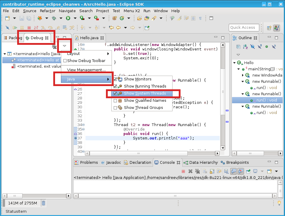

Rick, if possible please also try working with the setting "Show System Threads" in the Debug view.
You can enable this from the Debug view menu -> Java, see below:
index.php/fa/36314/0/
You will see more threads due to this, but at least in the snippet I've created I no longer see the problem with this setting (with about 50 repetitions anyway). So the setting maybe helps in the short run; knowing whether the setting helps will also narrow the potential causes down.
Note that fixing this might take some time, since right now I have no priority for it at work.
[snip image]
