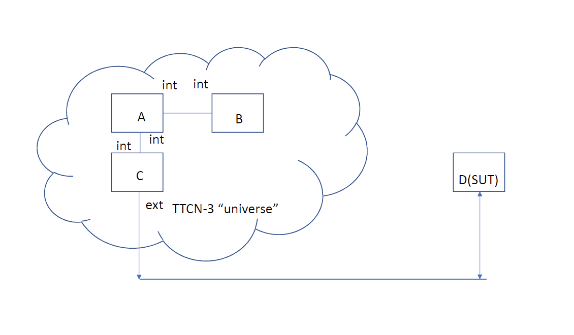

Re: Need help to run a DNS test for ttcn3 [message #1810611 is a reply to message #1810606] Wed, 14 August 2019 06:09 Go to previous messageGo to next message
Hi Sean,
first , internal and external ports:
The execution in a TTCN-3 code happens a separate universe; this universe can communicate with the external world only through test ports:
index.php/fa/36098/0/
To be able to simulate complex behaviours, the execution is segmented in components, which don't share any common variable space so they have to communicate via test ports also; these test ports, for obvious reasons, are classified as internal.
In the attached picture one can see a TTCN-3 execution of 3 components A,B,C
A has 2 internal ports, connected to B and C
B has 1 internal port connected to A
C has 1 internal port connected to A
and one external port mapped to the System Under Test -SUT (D)
Titan will take care of the internal communication on the connected ports
but for external ports a code that simulates the appropriate protocol stack
layer or layers will have to be chosen. In your case this is the UDP test port,
which will also have to have pertinent parameters to work properly.
Please read the documentation of the test port.
Other (theorethical ) options could be : TCP port, HTTP port, SIP port etc.
To be continued

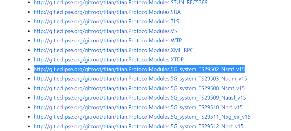

Re: Need help to run a DNS test for ttcn3 [message #1811161 is a reply to message #1811154] Tue, 27 August 2019 22:23 Go to previous messageGo to next message
Hi Elemer,
Sorry I didn't describe my question clearly,
I was just confused when I couldn't open this link
index.php/fa/36171/0/
on https://github.com/eclipse/titan.core, so I thought it was still in developing or something; however, I figured it out I should clone it.
Sorry if I'm bothering, and great thanks for your explanation.

Re: Need help to run a DNS test for ttcn3 [message #1811165 is a reply to message #1811161] Wed, 28 August 2019 00:20 Go to previous message
Hi Sean,
as it says in the description,
The links are meant to be used in git commands
Only. Sorry for the confusion.
BR
