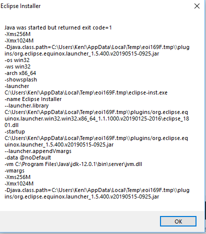

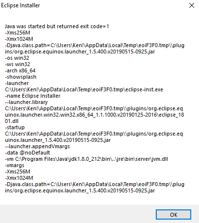

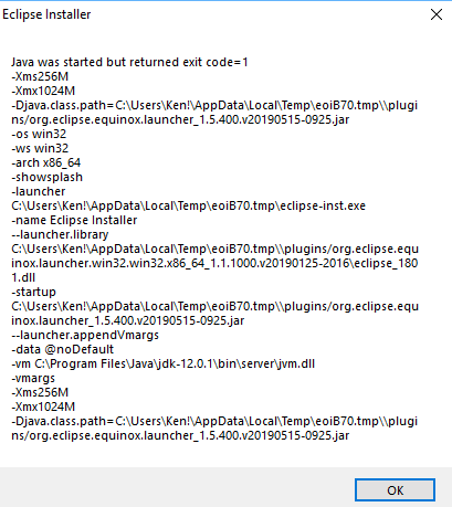

Re: Eclipse Installer error [message #1808494 is a reply to message #1808490] Tue, 25 June 2019 12:23 Go to previous messageGo to next message
So when I enter "C:\Program Files\Eclipse\eclipse-inst-win64.exe" -vm "C:\Program Files\Java\jdk-12.0.1\bin\java.exe", the installer comes up, but then gives the following error messages:

Re: Eclipse Installer error [message #1808495 is a reply to message #1808494] Tue, 25 June 2019 13:43 Go to previous messageGo to next message
In your new image I see a -vm specifying a jdk1.8.0_112, but also the server version. So I'm a bit confuse about what versions of Java you have. And it seems particularly odd that you get this new message when you specify some other -vm. Did you get the installer from this link?
https://www.eclipse.org/downloads/download.php?file=/oomph/epp/2019-06/R/eclipse-inst-win64.exe
You could try to specify the path of the java.exe in the bin folder of the jdk1.8.0_212 folder, though that should just be found just by default...

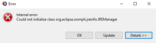

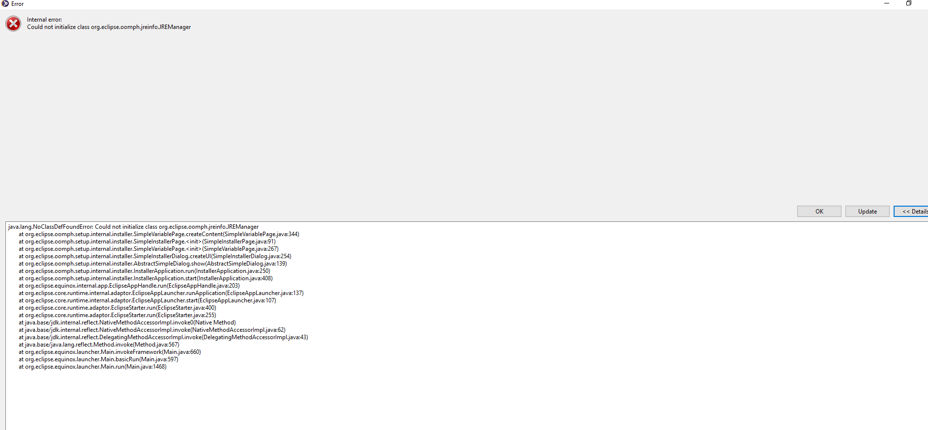

Re: Eclipse Installer error [message #1808498 is a reply to message #1808495] Tue, 25 June 2019 16:07 Go to previous messageGo to next message
The jdk1.8.0_112 was from an earlier attempt I had made on my own after getting a message saying "Java version needed to run Eclipse Installer couldn't be found on your system." I went ahead and did a fresh install of both Java and Eclipse just a minute ago to where I am getting the same original issue. The cmd prompt of "C:\Program Files\Eclipse\eclipse-inst-win64.exe" -vm "C:\Program Files\Java\jdk-12.0.1\bin\java.exe" still gives me an error message of:

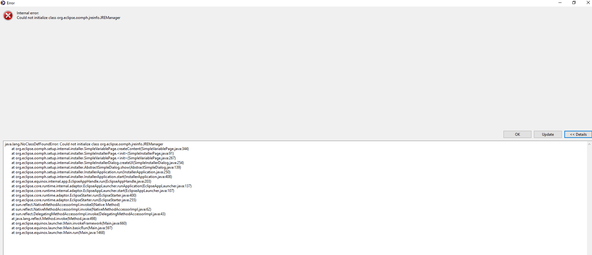

Internal Error: Could not initialize class org.eclipse.oomph.jreinfo.JREManager

Re: Eclipse Installer error [message #1808512 is a reply to message #1808498] Wed, 26 June 2019 01:06 Go to previous messageGo to next message
I see. So the installer shows you the first page and then when you click on the package/product you want to install, the installer terminates while turning to the second page (simple variable page).
Unfortunately the stack trace does not give me information about why the JREManager class could not be initialized. I'd need to see the full log file and would hope to find logged there prior failures that lead to the final failure.
If you use the installer's menu in the upper right on the first page of the installer, and switch to "ADVANCED MODE..." the installer will ask if you want to keep it in a permanent location. If that works, you can put it somewhere (that you remember where it is) in your file system.
Likely the first page of the advanced mode will fail in a similar way that the second page of the simple mode failed. But in this case you can find the log file in the <installer-location>/configuration/*.log and could attach that file to your forum post.
Alternatively you can find this log in the horrible "tmp" location that you see in the failure dialog, e.g., in the most recent example crash it would be under under C:\Users\Ken!\AppData\Local\Temp\eoi169F.tmp\configuration\*.log. The installer extracts itself to a temporary location and you can see that location in the crash dialog after the -startup line.
Of course you can also avoid using the installer and download something directly from here and unzip it:
But it would be nice to know why the installer is failing so that I can fix whatever the problem is...
