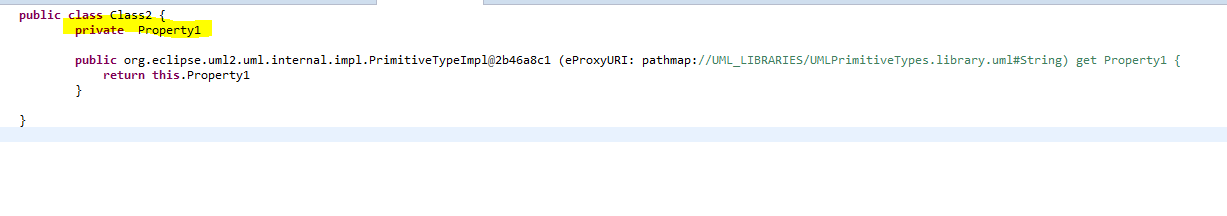

i have the generated given below
index.php/fa/35784/0/
In the result of the code the p.type.name is generating empty string. as given below
index.php/fa/35785/0/
can any when please guide me.

You omit all the relevant parts of your repro but it looks like a FAQ.
Shortly after your empty string is a proxy URI that reveals that you are using UML and that like many others you have neglected to read the instructions in the generated Java that tell you how to initialize usage of the UML metamodel.

Yes and there is a TODO that you have ignored:
     * This can be used to update the resource set's resource factory registry with all needed factories.
     * @param resourceSet
     *            The resource set which registry has to be updated.
     * @generated
    public void registerResourceFactories(ResourceSet resourceSet) {
        super.registerResourceFactories(resourceSet);
         * If you want to change the content of this method, do NOT forget to change the "@generated"
         * tag in the Javadoc of this method to "@generated NOT". Without this new tag, any compilation
         * of the Acceleo module with the main template that has caused the creation of this class will
         * revert your modifications.
         * TODO If you need additional resource factories registrations, you can register them here. the following line
         * (in comment) is an example of the resource factory registration.
         * If you want to use the generator in stand alone, the resource factory registration will be required.
         * To learn more about the registration of Resource Factories, have a look at the Acceleo documentation (Help -> Help Contents).
        // resourceSet.getResourceFactoryRegistry().getExtensionToFactoryMap().put(XyzResource.FILE_EXTENSION, XyzResource.Factory.INSTANCE);
         * Some metamodels require a very complex setup for standalone usage. For example, if you want to use a generator
         * targetting UML models in standalone, you NEED to use the following:
        // UMLResourcesUtil.init(resourceSet)
Ed Willink

Thanks so much for your help. I resolved the problem by the following two steps
1) In Generate.java file i removed comment from statment "UMLResourcesUtil.init(resourceSet);"
2) In MANIFEST.MF file i added statemtent " org.eclipse.uml2.uml.resources, "
Than so much for guiding me very well... I appreciate your help.
