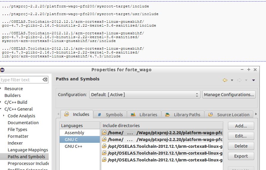

Re: Building 4diac FORTE for Wago issue [message #1805705 is a reply to message #1805608] Mon, 22 April 2019 06:22 Go to previous messageGo to next message
I have checked before writing here the paths for Paths and Symbols from the project . Were taken from the procedure ( https://www.eclipse.org/4diac/documentation/html/installation/wago.html ) , print screen attached above, everything seems to be fine. I'm thinking that from the procedure some information might be missing

Re: Building 4diac FORTE for Wago issue [message #1805746 is a reply to message #1805705] Tue, 23 April 2019 02:13 Go to previous messageGo to next message
Hi ,
As mentioned in the help file, the document was written based on an old version of wago BSP and ptxdist. Some procedure might have changed for the latest BSP. Thanks for noticing this change. Please try adding the following to your path,
~/wago/ptxproj-2.2.20/platform-wago-pfc200/sysroot-target/usr/include/OsLinux/
Hope this helps

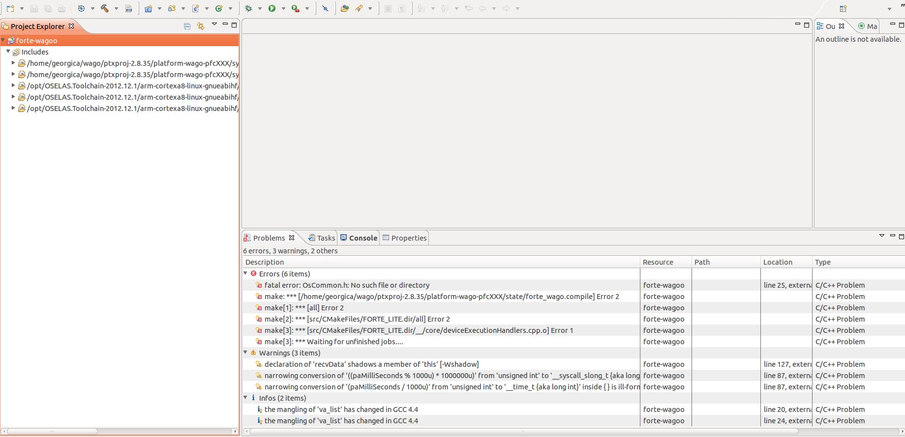

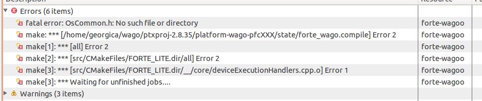

Re: Building 4diac FORTE for Wago issue [message #1805756 is a reply to message #1805746] Tue, 23 April 2019 04:32 Go to previous messageGo to next message
I have included the new path, cleaned the project , then rebuild and still the error remains.
Must say that ptxdist is version 2.8.35 and BSP 2018.08.27-2.8.35

Re: Building 4diac FORTE for Wago issue [message #1805762 is a reply to message #1805756] Tue, 23 April 2019 06:23 Go to previous messageGo to next message
From your screen shots, it looks like you have not imported forte source code in to the workbench. Have you imported forte project in to your workbench? If you have imported, your workbench looks ~what is attached here. The paths and symbols are then specific to this imported project.
To know more on how to import project in eclipse CDT please refer to the official document from wago, "How to Utilize EclipseCDT " . Also please make sure you have the corresponding file in the ptxproj (which you build before with ptxdist)
Re: Building 4diac FORTE for Wago issue [message #1805770 is a reply to message #1805762] Tue, 23 April 2019 08:16 Go to previous messageGo to next message
Somehow this step of importing forte source code is missing from the procedure in Eclipse CDT (or I haven't understood correctly the tutorial).
I have searched for the official document from wago on how to utilize Eclipse CDT but haven't found it (official website and search engines).

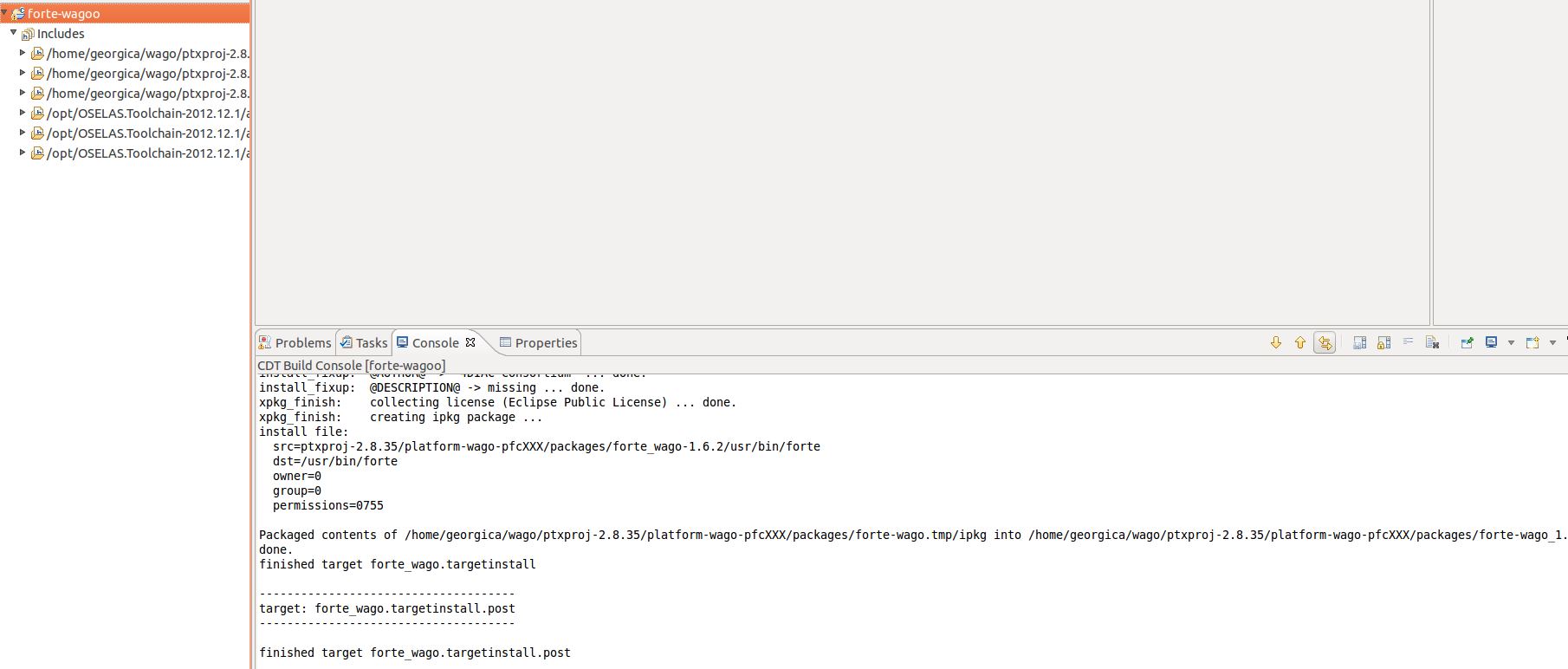

Somehow I managed to pass the error on building in EclipseCDT.
I saw that in console , next to that error of OsCommon.h was reading ldkc_kbus in sysroot-target->usr->include. I have copied OsCommon.h in the same folder and then rebuilded the project and now i think i have obtained the right thing. Project was builded without errors now (see attached photo).
But still I think i'm not completely error free, as you have said forte source code is missing or not ?

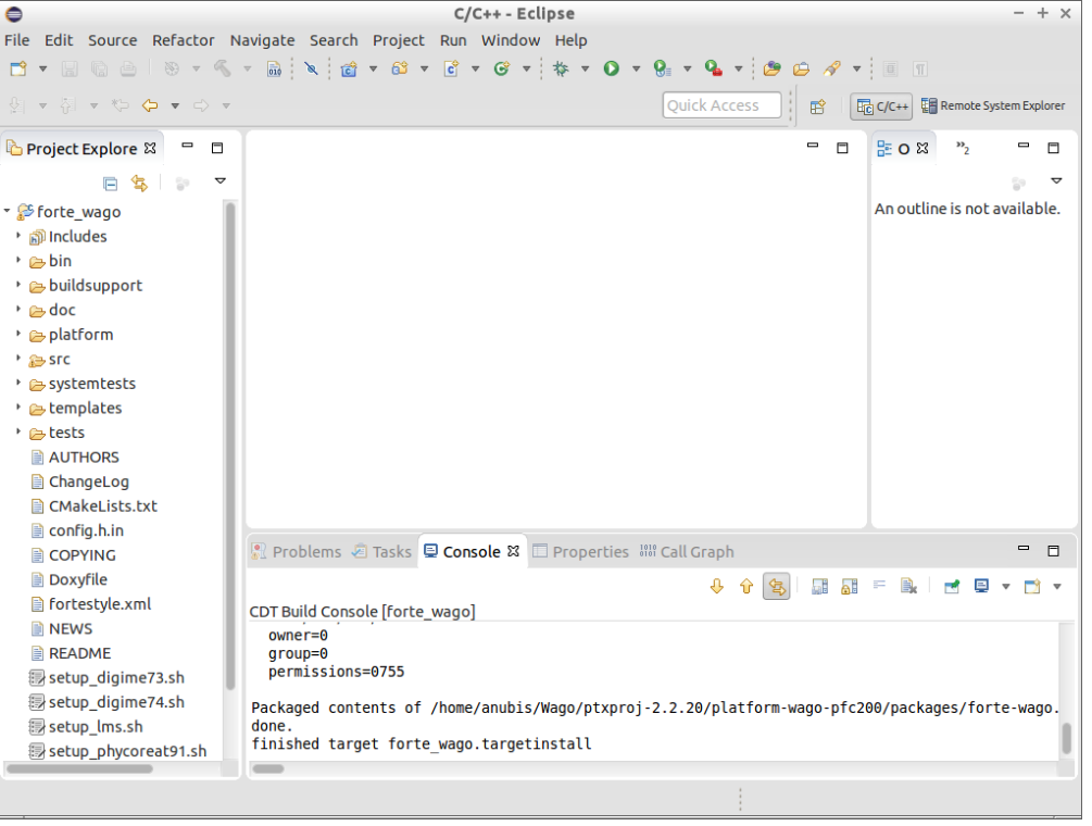

Re: Building 4diac FORTE for Wago issue [message #1807567 is a reply to message #1805775] Mon, 03 June 2019 14:12 Go to previous messageGo to next message
I have deleted previous post, unfortunately was a rookie mistake, which I solved it quickly.
But still ,I'm running out of ideas, since errors seems to stick to every step in this procedure which i'm trying to follow.

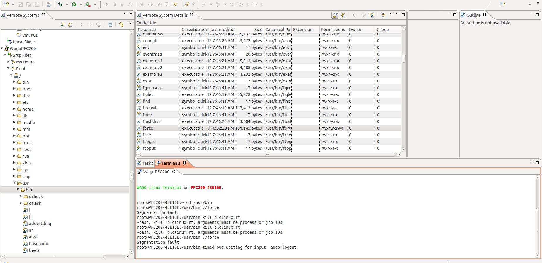

When running in Wago PFC200 hardware the execution of forte I'm receiving the following message in eclipse cdt :
index.php/fa/35671/0/
I must say that during build of the project there was no error and results where like in the procedure mentioned on this topic. Forte executable was copied successful in the wago hardware
[Updated on: Mon, 03 June 2019 14:22] by Moderator
Re: Building 4diac FORTE for Wago issue [message #1807597 is a reply to message #1807567] Tue, 04 June 2019 08:50 Go to previous messageGo to next message
Hi ,
From the screen shot you attached, , it looks like the codesys run time is still using the communication bus of the wago. As your terminal shows, when you try to kill a process, you should use
 kill <pid(ID of the process plclinux_rt)>
For getting the PID of your process plclinux_rt you may run the following code on your terminal
 ps -A
This deliver list all PIDs running on your machine. From the list find the ID of the process plclinux_rt and then kill this process. For example if the ID of plclinux_rt is 1433, it can be killed with
 kill 1433
Hope this helps.
Milan
Re: Building 4diac FORTE for Wago issue [message #1807661 is a reply to message #1807597] Wed, 05 June 2019 14:49 Go to previous messageGo to next message
Unfortunately the same error of segmentation fault even after killing codesys rt (after running the commands suggested by you above and finding PID and kill by that). You have suggested then to run the binary obtained from ptxdist directly in the hardware.
This means continue the procedure (How to install wago-pfc-bsp-version) after the step 7 Compile all packages of PFC hardware ? (step 7,8 and 9 ? )

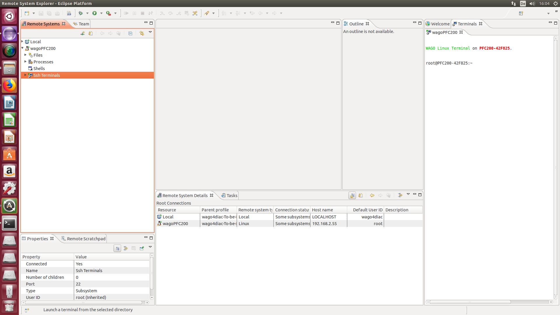

My problem is the step "A Terminal view should open as well as a Remote System Details view". There, I don't have the same output and can't connect to the wago plc.
I am grateful for any help and support.

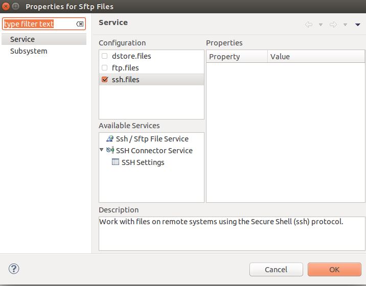

I had the same problem. The procedure that we quote here, doesn't show how to configure in Eclipse CDT the environment for working with forte and Wago hardware. Should be found normally under Eclipse documentation, but I haven't found that either.
Therefore I learned by doing :
Right Click on Sftp Files -> Properties -> then you should uncheck dstore.files and check ssh.files :
index.php/fa/35750/0/
