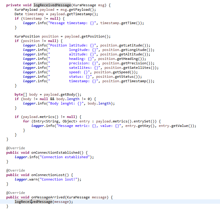

I'm expecting the Logger String on the following Callback
public void onMessageArrived(KuraMessage message) {
logReceivedMessage(message);
logger.debug("//////////////// OnReceivedMessage ///////////////////");

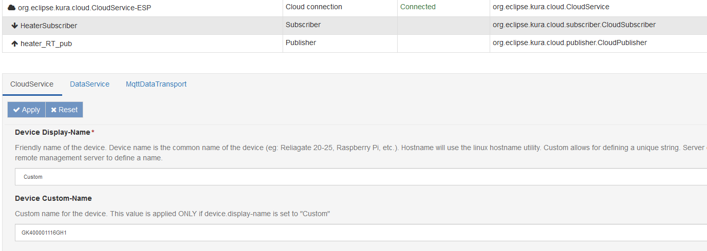

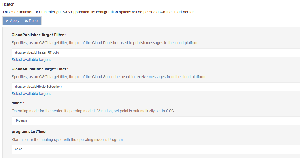

I have attached two pictures of Kura WEB UI configuration

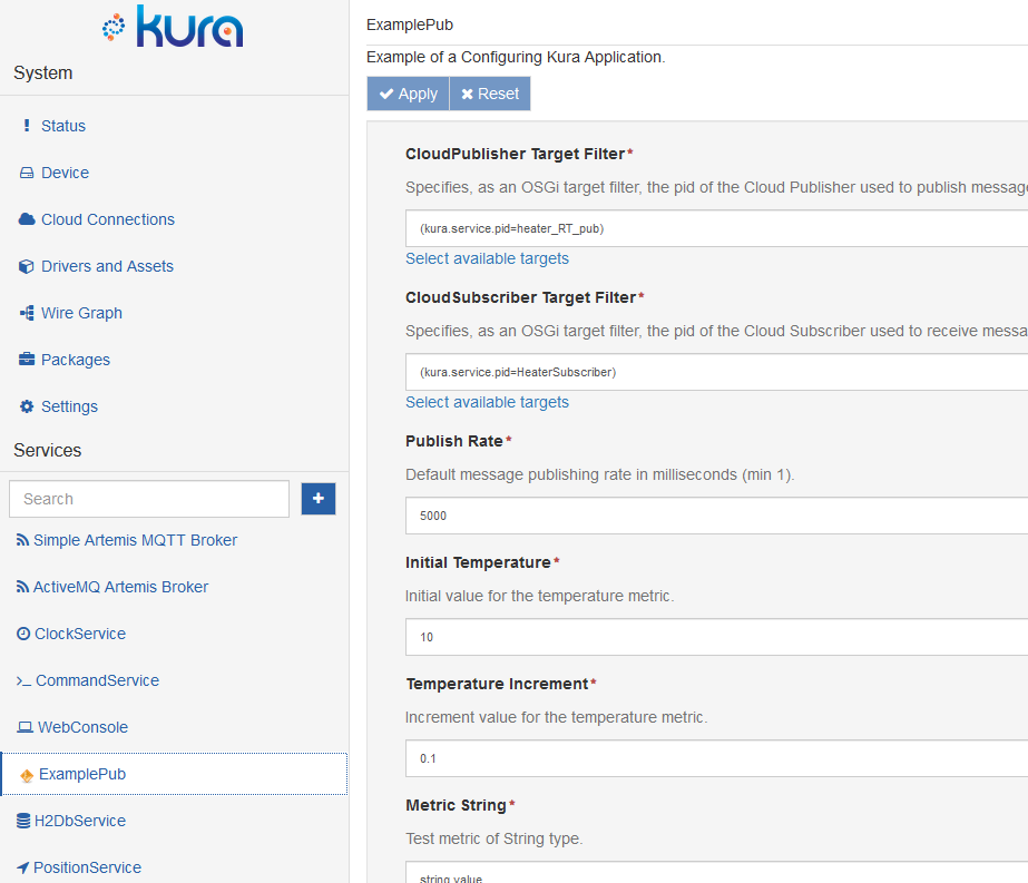

Compared to the heater that is a singleton component that has a single instance that automatically starts, the example publisher is a factory. To instantiate it, you need to use the + button on the left, select the example publisher factory and provide a name. It will create a new instance that will be listed in the services section of the web UI.
Matteo

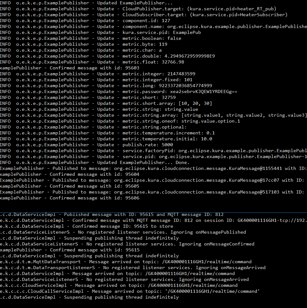

Re: [kura 4.1.0]Problems with CloudSubscriber [message #1807622 is a reply to message #1807618] Wed, 05 June 2019 06:09 Go to previous messageGo to next message
You are right but nothing is changed.
see files attached.
the method
private void logReceivedMessage(KuraMessage msg)
never shows up when message arrives on topic.

What is the configuration of the "heaterSubscriber" component?
Re: [kura 4.1.0]Problems with CloudSubscriber [message #1807634 is a reply to message #1807633] Wed, 05 June 2019 07:48 Go to previous messageGo to next message
Application Id: realtime/command
Application Topic: (empty)
Qos: 1
Kind of Message: Data
Re: [kura 4.1.0]Problems with CloudSubscriber [message #1807886 is a reply to message #1807634] Tue, 11 June 2019 10:17 Go to previous message
