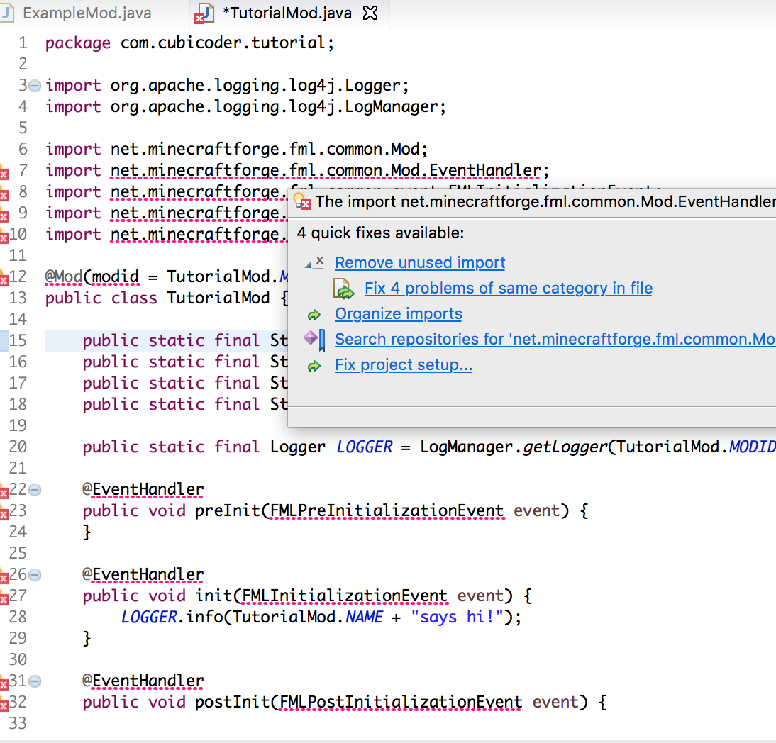

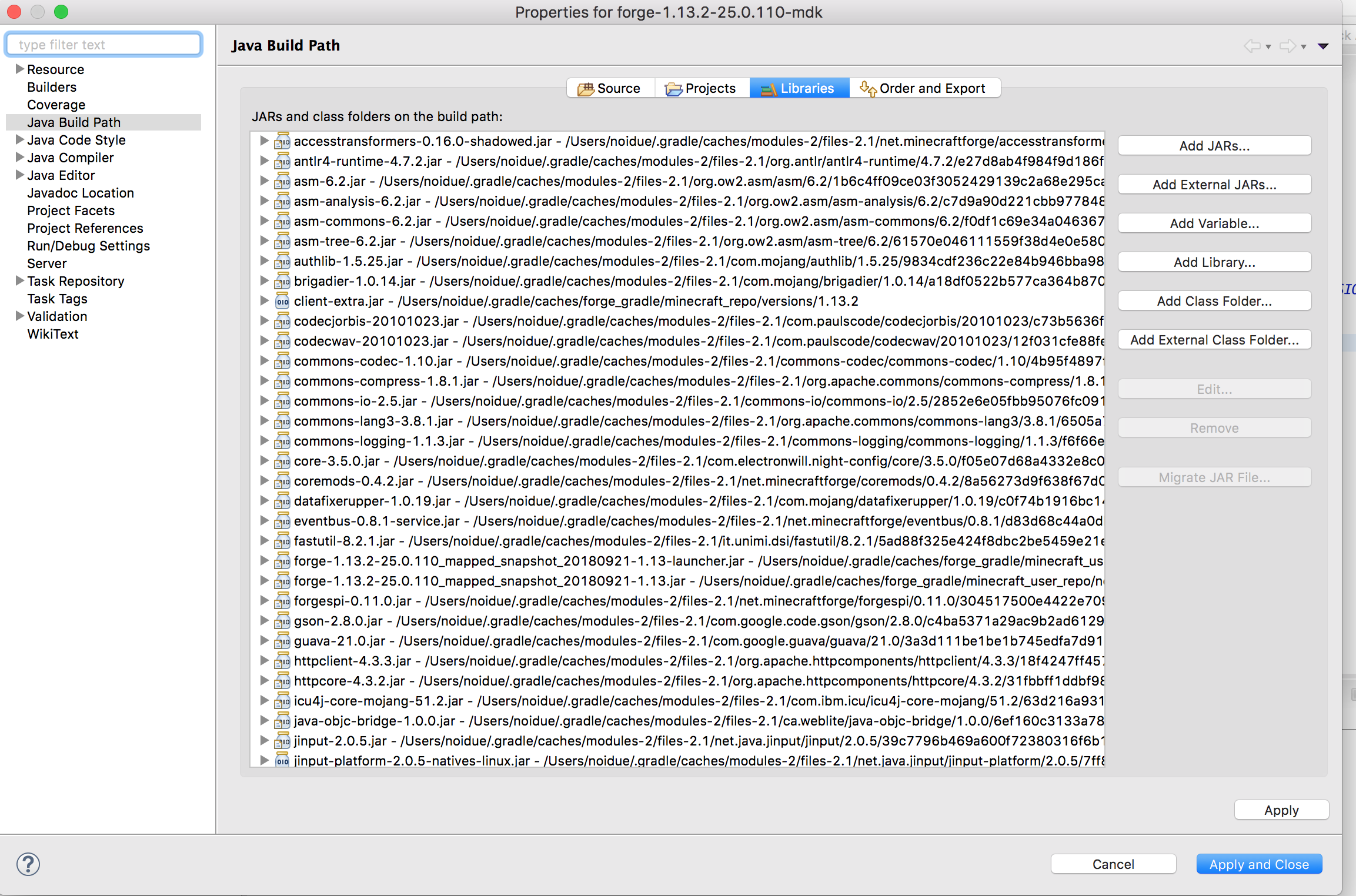

Re: "Cannot be resolved to a type" error [message #1805899 is a reply to message #1778863] Sat, 27 April 2019 04:13 Go to previous messageGo to next message
I have the same error with 1.13.2
any ideas?

Re: "Cannot be resolved to a type" error [message #1805902 is a reply to message #1805899] Sat, 27 April 2019 06:52 Go to previous messageGo to next message
It seems the first import resolves correctly. Can you F3 to the source from that? Is the source what you'd expect with a nested annotation like what I see here:
https://github.com/MinecraftForge/FML/blob/master/src/main/java/net/minecraftforge/fml/common/Mod.java
Re: "Cannot be resolved to a type" error [message #1805908 is a reply to message #1805902] Sat, 27 April 2019 13:26 Go to previous messageGo to next message
yes it goes in Mod.class
Re: "Cannot be resolved to a type" error [message #1805909 is a reply to message #1805908] Sat, 27 April 2019 13:28 Go to previous messageGo to next message

Re: "Cannot be resolved to a type" error [message #1805919 is a reply to message #1805909] Sat, 27 April 2019 23:37 Go to previous messageGo to next message
Well that kind of explains it doesn't it? I.e., the things you're trying to import aren't present in the version of the library you have on your classpath. Perhaps you have an older version where these aren't yet present or you have a newer version where these things have been removed. You'll have to find an appropriate version to use or adjust your code to work with the version you have.
Re: "Cannot be resolved to a type" error [message #1805926 is a reply to message #1805919] Sun, 28 April 2019 10:12 Go to previous message
That's right, thanks
