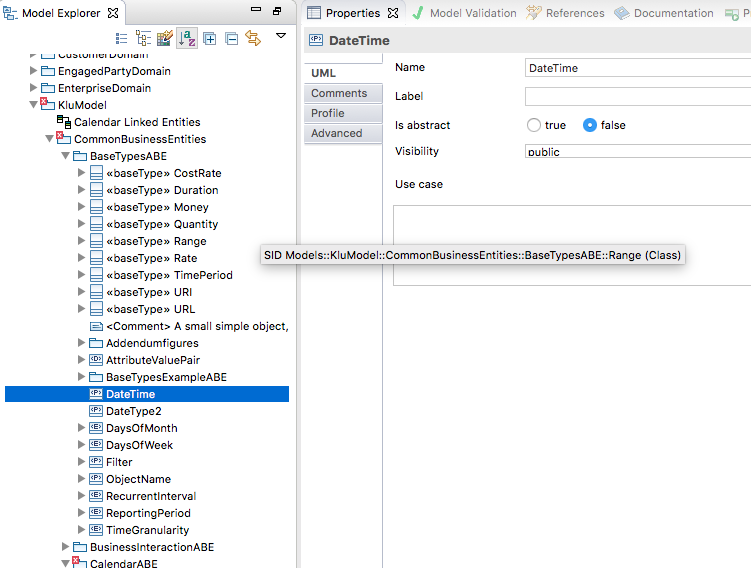

I have managed to create a model and I want to generate the corresponding java code however, the "Primitive" data types are not generated probably because I don't know how to map them them to java primitive types correctly. for example I want to define a DateTime primitive data type that should be mapped to java.util.Date . Should I use a specific stereotype or a redifined classifier to something else?
I am using papyrus 2018-12 (4.10) and the designer update site: http://download.eclipse.org/modeling/mdt/papyrus/components/designer/. I have created a UML model and I have managed to generate Java Project
