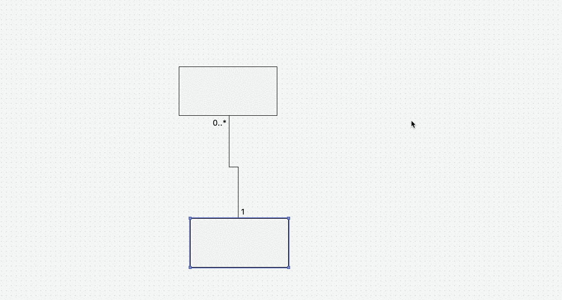

Hello Matthias,
So basically I have cardinalities on 2 Nodes, when I move one of them I want that the cardinalities are aligned correctly depending on the position and therefore I need to Update the connection its visuals by using the method
doRefreshVisual(Connection visual)
from the class
DiagramConnectionPart
but if I move one node this method is never invoked.

Re: Calling the doRefreshVisual Method [message #1803199 is a reply to message #1803189] Mon, 25 February 2019 04:38 Go to previous messageGo to next message
Hi Servan,
within GEF, only visual changes are performed during interaction (usually). These are complemented by content changes upon completion of interaction. This is when doRefreshVisual() should be executed in order to adapt the visualisation to the contents.
The default mechanisms execute BendVisualOperation while manipulating a Connection. Therefore, setVisualBendPoints() is invoked during those interactions, updating the connection visual.
Basically, you can change the visual in any way during interaction, and then ensure that the next refresh will yield the same result.
Therefore, you are not bound to the Connection or IBendable API. Instead, you can subclass the TranslateOnDragHandler and invoke a custom method, e.g. connectionPart.updateLabels(). However, when completing interaction, you have to change the content so that the next doRefreshVisual() will show the same updated labels.
Matthias
