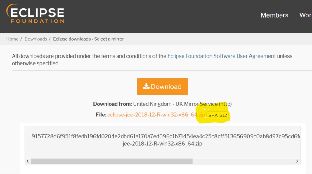

Just my two cents worth of remarks...
Have you ever try to download a zip file from:
and then verify the file using the SHA-512 .
The installation is just unzipping the file to a folder of your choice.
e.g.
https://www.eclipse.org/downloads/download.php?file=/technology/epp/downloads/release/2018-12/R/eclipse-jee-2018-12-R-win32-x86_64.zip
Will take you here:
You need to click on the "sha-512" button
index.php/fa/34665/0/
Regards.

Re: 2018-12 Eclipse Installation Error [message #1801232 is a reply to message #1801227] Tue, 15 January 2019 11:18 Go to previous messageGo to next message
Just for testing I just download
https://www.eclipse.org/downloads/download.php?file=/technology/epp/downloads/release/2018-12/R/eclipse-java-2018-12-R-win32-x86_64.zip&mirror_id=1190
Checksum OK !!!
It was from Germany - University of Erlangen-Nuremberg (http) (I am from Israel)
You were saying "Maybe I have to wait sometime until I have a new mirror ..."
you can decide on a different mirror
Good luck !
