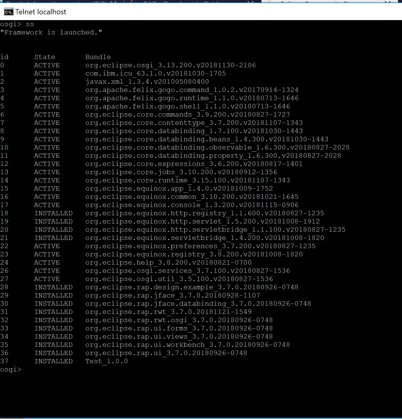

The war is generated and looks ok, if I compare it to existing and working war files.
But the dependency to javax.servlet ist not resolved. All bundes, that require javax.servlet are not startet with the message, that the requirement is not resolved (see shell output).
index.php/fa/34585/0/
Can anybody tell me where the I can tell the web app to retrieve the javax.servlet from the tomcat? (I tried it with tomcat 7 and 8.5.) Do You see a major bug in my POM?
I assume, that some manifest is not generated appropriately. But I don't know where the mistake is. Or are some launch configurations missing?
Just to be complete: I also tried to add javax.servlet to the war file. This worked so far that all bundles startet. But the entry point would still not be opened.
Many thanks for your help in advance!

Hi, Check out this thread for Info on libra war product: https://www.eclipse.org/forums/index.php/t/1093948/
Concerning tycho: i think you followed the same tutorial as i did to create the war. there is one lib in the template. This lib is too old , i replaced it with the newest version and it worked like a charm

Thanks a lot! That was a late christmas present for me! One of the best ;-)
