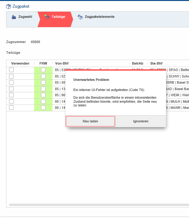

Sadly, that does not really help me to locate the code that causes this issue. Is there an easy way to get back from the compiled & minified angebot-all.js line reference to the original javascript code?
What does "Code T6" stand for? As far as we know, these codes usually consist of the first letter of the exception that is thrown plus the length of its name, but we're not aware of any 6-letter exceptions starting with T...

The code T6 indicates the type of JavaScript error, but has no significance otherwise. See ErrorHandler.js
