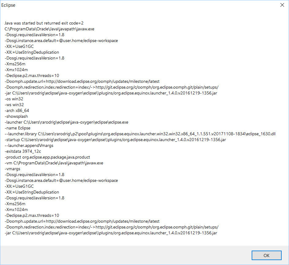

I have been using 'Eclipse IDE for Java Developers' for several months and suddenly Eclipse is not able to open anymore.
When I try to open it I got these error messages in sequence:
1. Error opening registry key 'Software\JavaSoft\Java Runtime Environment'
2. Error: could not find java.dll
3. Error: could not find Java SE Runtime Environment
4. <very long text shown in the picture attached>

You appear to have a corrupted version of java installed. I can't be sure of the exact issue, but I would suspect a failed uninstall of an older version or some conflict when installing a new version. From the log file you posted, the java executable being run is C:\ProgramData\Oracle\Java\javapath\java.exe. This is giving the first three error messages that you list. Searching the internet for this path name seems to indicate that Oracle started using this location with Java 8. It seems its purpose is to use the registry to locate the actual VM to run. Eclipse runs in the java VM, so it won't be able to run until java can be started cleanly. I would focus on getting the java -version command to run successfully. After that, you can move on to getting Eclipse running again.

Hi all.
Just in case somebody faces the same problem, I managed to solve it.
1) Somehow, Java Runtime Environment got uninstalled from my PC. I installed it BUT I still faced a lot of problems because of the JRE installation file I got by default was for Win 32b (it could be installed without problems) but that generated a mismatch between JavaRE and Eclipse and JDK. So please be sure you installed all of the same time (32b or 64b)
Lack of Java Runtime Environment gives this on CMD
C:\>java -version
Error: opening registry key 'Software\JavaSoft\Java Runtime Environment'
Error: Could not find Java SE Runtime Environment.
2) I reinstalled JDK for 64b
After that, Eclipse started-up as before.
