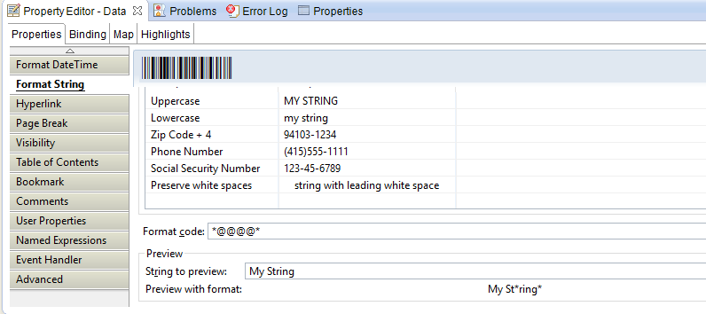

Re: creating barcodes in BIRT Designer [message #1816213 is a reply to message #1792839] Wed, 23 October 2019 19:44 Go to previous messageGo to next message
A custom format using *@@@@* seemed to work. The number of asterisks must correlate to number of digits...
  • Attachment: Capture.PNG
    (Size: 23.13KB, Downloaded 352 times)
