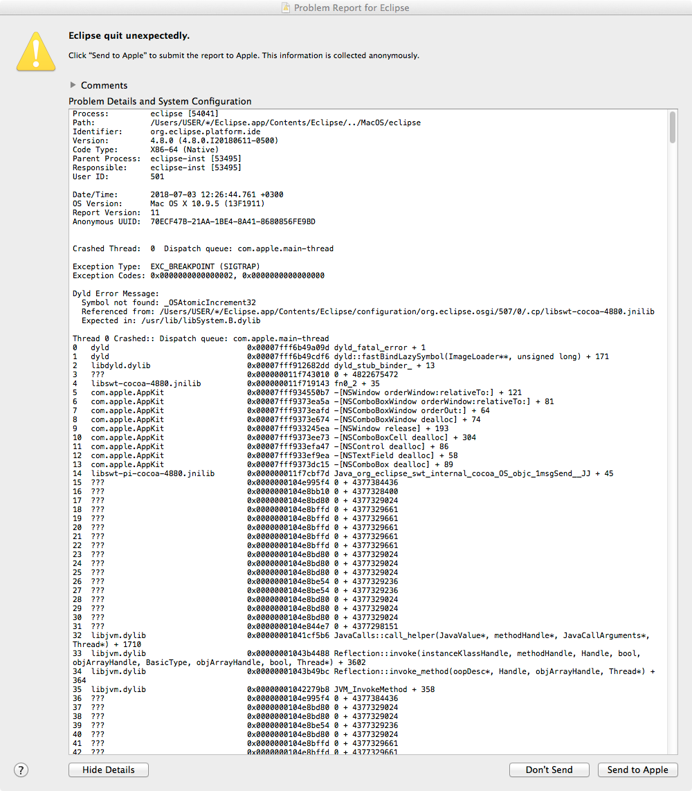

Photon crashes immediately after installation on OS X 10.9.5, with Oracle Java version 1.8.0_131 (and 1.8.0_172). The splash screen shows for a while, and the main loop gets an operating system trap.
There are no Eclipse logs to be found.
OS X crash report files attached.
Any pointers how to proceed?

I have tried the Photon (freshly installed using the installer) on two different computers (MacBook Pro and Mac Pro), and both crash without giving a clue. From the crash message it seems that the windowing toolkit is attempting to use a dynamically linked module from OS X, and the module is not available of some reason.

Please create a bug report with all these details. I suggest it's an SWT issue, so here's a convenient link to get you started: https://bugs.eclipse.org/bugs/enter_bug.cgi?product=Platform&component=SWT
Keep in mind that OS X 10.9.5 is at least 2 major releases old, so the SWT team may or may not have the resources to address the problem.
