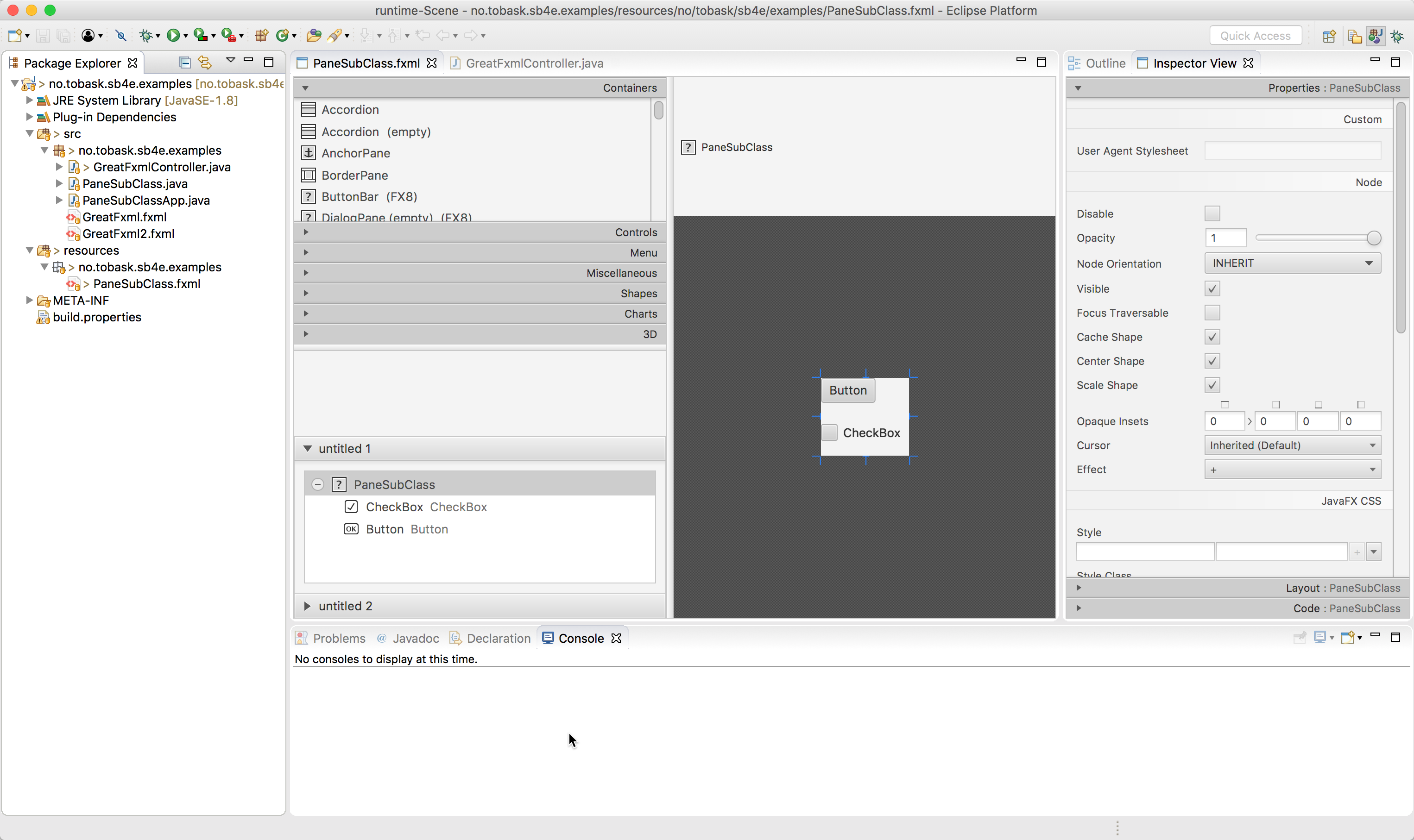

There's an old bug asking for SceneBuilder as an Eclipse editor (https://bugs.eclipse.org/bugs/show_bug.cgi?id=408408). I'm happy to tell that a master project I'm supervising has produced a prototype of this (and he's not done, yet) available at https://gitlab.stud.iie.ntnu.no/tobiaas/scene-builder-plugin and installable from http://files.idi.ntnu.no/publish/sb4e-SNAPSHOT/repository/
It builds on Gluon's SceneBuilder and runs on Eclipse Oxygen, e(fx)clipse 3.1.0 (I believe) and Java 8 (for now).
Features
- open and edit FXML files
- the Inspector is a separate, linked view
- loads files using containing project's class path, so you can use custom controls and controllers
See image below!
He's still working on it and will be happy for feedback and/or issues at his gitlab site.
