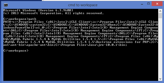

BTW my environment variables just has PATH set pointing to jdk 10 (attaching screenshot of the path variable).
