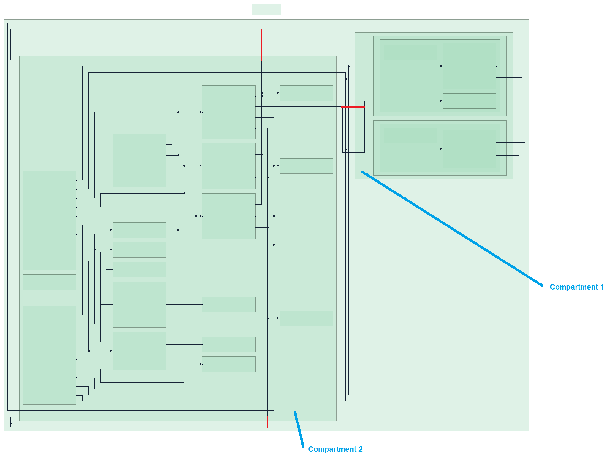

i've currently implemented a graph which needs nodes with 2 different compartments which contain childs.
Is it possible to define a specific node placing or an orientation of the nodes? Is it possible to shorten long edges?
My layouting result is attached.
- Red lines are my opinion of shortened edge routing
- Blue lines with text are showing the two compartments
The two compartments are layouted horizontally, but i need them in vertical order. The small compartment (Compartment 1) in the right side should be above the other compartment (Compartment 2).
There is also a problem with the edge routing. In this example graph i've discovered 3 easy edges, which could be routed shorter. (3 red lines)
I'm using the layered layouting algorithm with the following properties (only regarding my problem):

If I understand your problem correctly, it is not related to crossing minimization as suggested by Miro.
You could set a DOWN layout direction on the node containing the two compartments, although I'm not sure if that's what you want.
Regarding the red lines: Whenever an edge crosses the boundary of a node, internally a port is introduced. Layout is performed bottom-up. Thus, when Compartment 1 is laid out, for instance, the introduced ports have to fixed somehow. The default behavior is that for a left-to-right layout direction ports for "incoming edges" are placed on the WEST side, for "outgoing edges" on the EAST side. That's the reason why the edges take the long detours.
I'm not sure how well your use case can be solved by setting proper layout options. If you can share an elkg or elkt file with your graph's structure, I could give it a try.
Re: compartment positions and smarter edge routing [message #1772683 is a reply to message #1772547] Wed, 13 September 2017 16:00 Go to previous messageGo to next message
Thank you for your help. Setting the direction explicitly to "down" worked. I've exported the Elk Graph model and attached it. The problem regarding edge routing still remains.

This is quite a hard problem.
First of all,
my suggestion regarding the layout direction
is only partly a solution.
You require hierarchical layout (hierarchyHandlung: INCLUDE_CHILDREN)
as you have edges that cross multiple hierarchies.
In that case, only a single (global) layout direction is supported,
i.e. if you set it to RIGHT at the root node, the whole graph will be laid out rightwards.
The issue with the edges originates
from the fact that
edges are routed somewhat simultaneously
to the placement of nodes.
Horizontal red line:
This is an unfortunate
outcome originating
from the interplay
between crossing minimization (phase 3)
and node placement (phase 4).
The crossing minimization
decides the vertical order of the edge segments,
and cannot know about 'edge length',
since the subsequent node placement
phase decides which edge to draw straight
Vertical red lines:
Edges that cross the boundary of a
hierarchical node
are split using dummy ports.
The default behavior to position
these dummy ports is
to place ports
through which edges are "incoming" on the west side,
and "outgoing" ports on the east side.
This results in the elongated 'back-and-forth' edges.
We encountered both points before;
they surely are something that should be improved.
However, I'm not sure that we'll have the
time to look into these issues in the near future.
