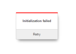

I am new to scout. I followed the tutorial, launching the server and ui within eclipse works. However, after deploying the war files on tomcat and logging in (either with scott or admin) leads to an initialization failed error.
I have not worked with tomcat either. Is there a way to see the logs to see what could be causing this?

If that happens, the initial startup request to the server failed. The UI is therefore not initialized and got no texts or other information from the server, therefore it can only display this very basic error message.
To find the real cause of the problem, you have to check the server logs. The exact location of those depend on your logging configuration (the tomcat docs for details). A good point to start your search would be the "logs" directory inside the tomcat installation directory. Under a Linux environment, "/var/log/tomcat" or similar is also not uncommon.
