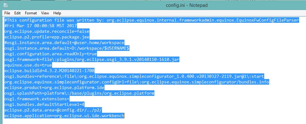

Hi Dave,
In my organization we did following. Check if this helps & relevant
In unix server we did the following
1. one Eclipse with pre-installed features to support everyone in one drive(Ex:C:) - read only for others
2. D - drive we have created user id folder with permission to that user alone.
Similarly we have created multiple users
3. Provided eclipse instances to everyone through Citrix
Our config.ini file is have the configuration as below
Thanks & Regards
Karthik Natarajan
  • Attachment: config.jpg
    (Size: 109.34KB, Downloaded 2170 times)
