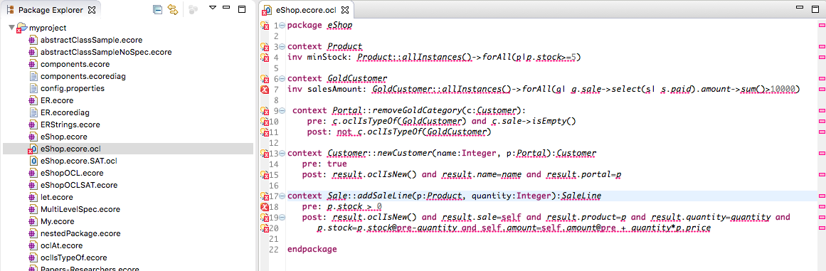

When I open an .ocl file in eclipse, I have several errors (Unresolved " 'eshop', etc.). I attached the related screenshots for the program and installed ocl software.
I also registered the metamodel. However, the errors didn't disappear.

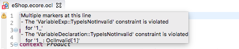

On line 1, import statement, I have bellow warning:
index.php/fa/29650/0/

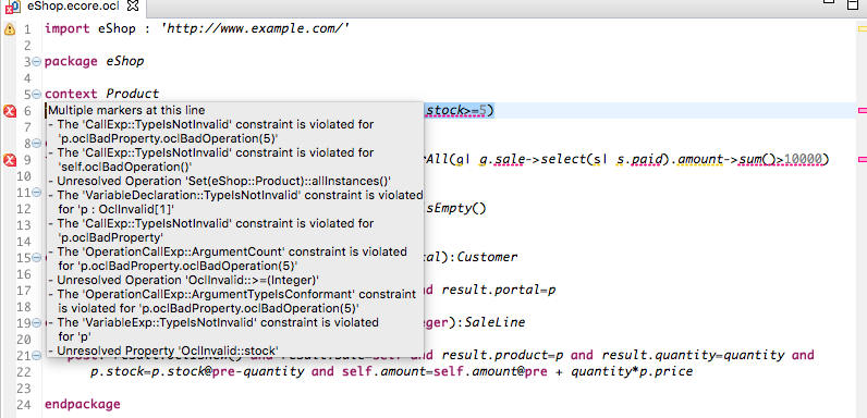

For line 6, inv minStock: Product::allInstances()->forAll(p|p.stock>=5), I have the bellow error:
index.php/fa/29651/0/

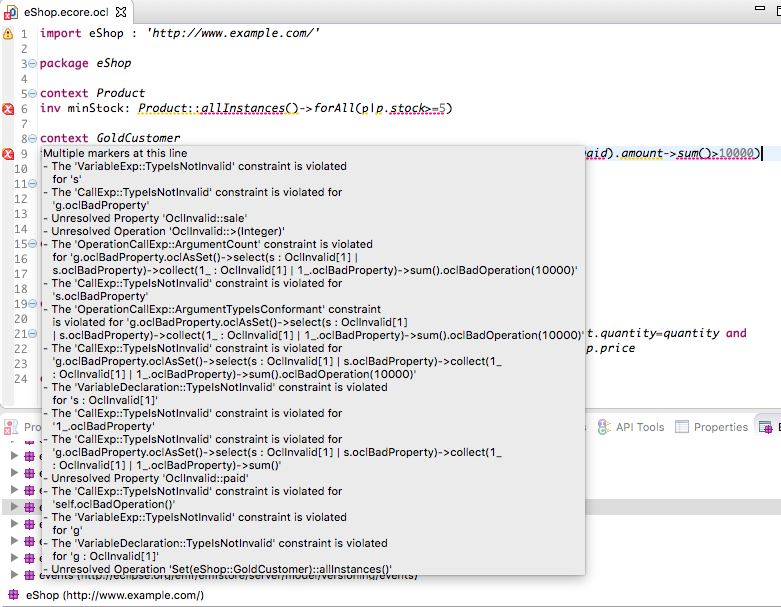

on line 9, inv salesAmount: GoldCustomer::allInstances()->forAll(g| g.sale->select(s| s.paid).amount->sum()>10000), I have the bellow error:
index.php/fa/29652/0/
