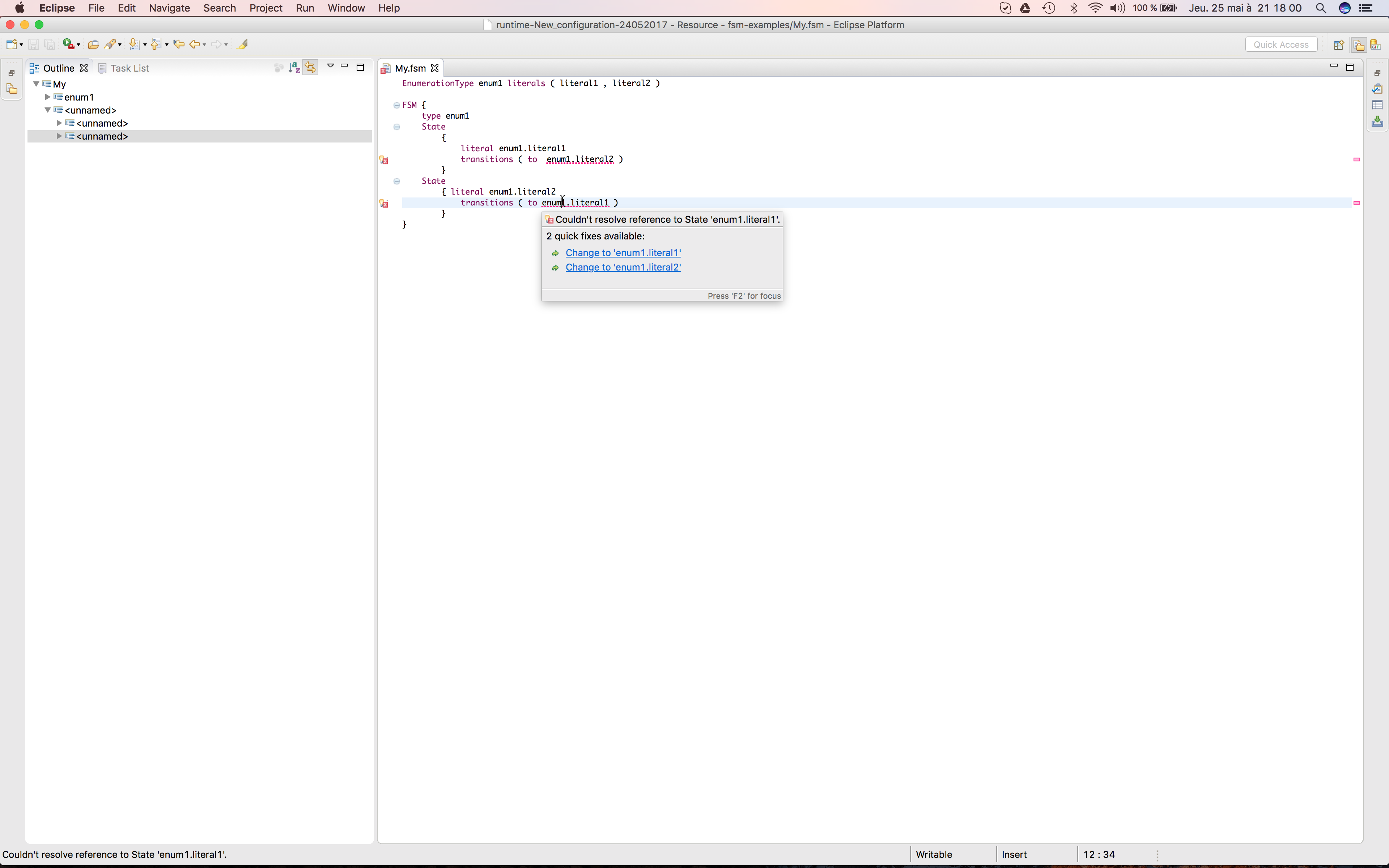

However, when I edit my model an error wizard appears
index.php/fa/29453/0/
and additional errors appear in the console as shown in below.
Any suggestion?

  • Attachment: xtextfsm.png
    (Size: 157.93KB, Downloaded 1708 times)
Re: resolution of uriFragment '|0' failed. [message #1764139 is a reply to message #1764137] Thu, 25 May 2017 15:11 Go to previous messageGo to next message
You don't call super in your scope provider
Thus you implicitly return null
That's bad
Call super.getScope(ctx, ref) or return IScope.NULLSCOPE

However errors on transitions (Couldn't resolve reference to State 'enum1.literal2'.) reappear as shown in the image
index.php/fa/29454/0/
the strange thing is that the editor proposes 2 quick fixes.
It couldn't resolve reference to State 'enum1.literal1' on the hand, and proposes quick fixes containing one of provided element ('enum1.literal1') on the other hand.
Is it normal?

Re: resolution of uriFragment '|0' failed. [message #1764142 is a reply to message #1764140] Thu, 25 May 2017 15:34 Go to previous messageGo to next message
Your states have no names do they?
You can reference only things with name
Either direct or with IQualifiedNameProvider
Or in the scope as you do
Please make sure you created the scope elements correct
Ok: QualifiedName.create("a","b")
Bad: QualifiedName.create("a.b")
Re: resolution of uriFragment '|0' failed. [message #1764143 is a reply to message #1764142] Thu, 25 May 2017 15:40 Go to previous messageGo to next message

Re: resolution of uriFragment '|0' failed. [message #1764209 is a reply to message #1764208] Fri, 26 May 2017 12:42 Go to previous messageGo to next message
I can have a look next week
As I said the linking should not need customization but you need to debug it to find out what caused yesterday's error
Re: resolution of uriFragment '|0' failed. [message #1764211 is a reply to message #1764209] Fri, 26 May 2017 12:54 Go to previous messageGo to next message
Ok Christian
If you want to reproduce, the whole code and example are available here https://github.com/fzalila/xtextfsm
When I debug the getLinkedObjects method, I observe that when the context is a Transition and the reference is target,
the result object is an EnumerationLiteral. However, the result object must a State and not an EnumerationLiteral.
So, I add a conditional statement to detect this case and the result value (in this case) becomes the state who refers to the concerned literal (and not the literal itself as returned by default).
Therefore, I add the getReferringState method that search the concerned state.
This customized behavior resolve the Couldn't resolve reference to State 'enum1.literal2'.
Actually, the problem is when I test the parser, the references are not resolved.
                final EObject result;
		if (context instanceof Transition && ref.getName().equals("target")) {
			State state = getReferringState((EnumerationLiteral) eObjectDescription.getEObjectOrProxy());
			result = state;
		} else {
			result = eObjectDescription.getEObjectOrProxy();
private State getReferringState(EnumerationLiteral literal) {
		EnumerationType type = (EnumerationType) literal.eContainer();
		Model model = (Model) type.eContainer();
		for (FSM fsm : model.getFsm()) {
			for (State state : fsm.getOwnedState()) {
				if (state.getLiteral() == literal)
					return state;
		return null;
Re: resolution of uriFragment '|0' failed. [message #1764220 is a reply to message #1764211] Fri, 26 May 2017 14:03 Go to previous messageGo to next message
well i had a look with my parents pc.
in your test you miss a
EcoreUtil.resolveAll(result.eResource.resourceSet)
besides this i dont get any errors in the editor nor in the test (using xtext 2.12)
if i revert the changes to linking service i get the error you describe
and the cause is clear
EObjectDescription.create(
QualifiedName.create((state.literal.eContainer as EnumerationType).name, state.literal.name), state.literal))
you add literals to the scope. not states
you may want to do a
QualifiedName.create((state.literal.eContainer as EnumerationType).name, state.literal.name), state))
instead
Re: resolution of uriFragment '|0' failed. [message #1764221 is a reply to message #1764220] Fri, 26 May 2017 14:19 Go to previous messageGo to next message
Sorry Christian for this trivial error. Yes it must be state and not state.literal.

Both tests testCorrectParsing and loadmodel are correct.
However, despite the add of EcoreUtil.resolveAll(result.eResource.resourceSet) the generated xmi is always doesn't contain the resolved references
<?xml version="1.0" encoding="ASCII"?>
<fSM:Model xmi:version="2.0" xmlns:xmi="http://www.omg.org/XMI" xmlns:fSM="http://www.xtext.org/example/mydsl3/FSM">
  <types name="enum1">
    <literals name="literal1"/>
    <literals name="literal2"/>
  </types>
  <fsm>
    <type href="__synthetic0.fsm#|0"/>
    <ownedState>
      <literal href="__synthetic0.fsm#|1"/>
      <outgoingTransition>
        <target href="__synthetic0.fsm#|2"/>
      </outgoingTransition>
    </ownedState>
    <ownedState>
      <literal href="__synthetic0.fsm#|3"/>
        <target href="__synthetic0.fsm#|4"/>
    </ownedState>
  </fsm>
</fSM:Model>
and this error is always here during loadModel test
