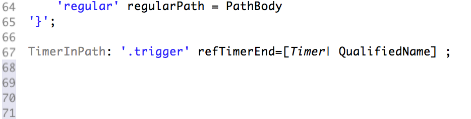

Yes, only a TImerInPath is.. which then refers to Timer by -
TimerInPath: '.trigger' refTimerEnd=[Timer| QualifiedName] ;
In other words, I need to refer to TImer via TimerInPath. For e.g.
when i refer to timer, it should be like in red below:
start startPoint -> .trigger getPIN
So i don't want to have a Timer in ReferencedEnd but only TimerInPath.
Re: Cannot be resolved [message #1763587 is a reply to message #1763582] Wed, 17 May 2017 12:22 Go to previous messageGo to next message
dont get that
TimerInPath is used nowhere
Re: Cannot be resolved [message #1763588 is a reply to message #1763587] Wed, 17 May 2017 12:43 Go to previous messageGo to next message
Okay. So TimerInPath is a kind of ReferencedEnd you see.
ReferencedEnd: OrJoin | TimerInPath ;
and is the last rule in my xtext. defined as:
where it makes a reference to Timer by refTimerEnd= [Timer| QualifiedName]

start startPoint -> .trigger getPIN is verboten in the grammar you posted
maybe you have a different grammar now.
but if you want to reference a reference you need something like
def QualifiedName qualifiedName(TimerInPath t) {
val name = NodeModelUtils.findNodesForFeature(t, MyDslPackage.Literals.TIMER_IN_PATH__REF_TIMER_END).head.text.trim
System.err.println(name)
return qnc.toQualifiedName(name)

Re: Cannot be resolved [message #1763601 is a reply to message #1763600] Wed, 17 May 2017 14:03 Go to previous messageGo to next message
TimerInPath is still uncalled in the grammar
[Updated on: Wed, 17 May 2017 14:04] by Moderator
Re: Cannot be resolved [message #1763602 is a reply to message #1763601] Wed, 17 May 2017 14:06 Go to previous messageGo to next message
see the color (gray)
Re: Cannot be resolved [message #1763604 is a reply to message #1763602] Wed, 17 May 2017 14:07 Go to previous messageGo to next message
Doesn't ReferencedEnd: OrJoin | TimerInPath ; mean that ReferencedEnd could be either an OrJoin or TimerInPath?
How can we call this then? I want this to be a ReferencedEnd.
Re: Cannot be resolved [message #1763605 is a reply to message #1763604] Wed, 17 May 2017 14:10 Go to previous message
yes but ReferencedEnd is uncalled as well. you just reference it, but nowhere "contain" it
